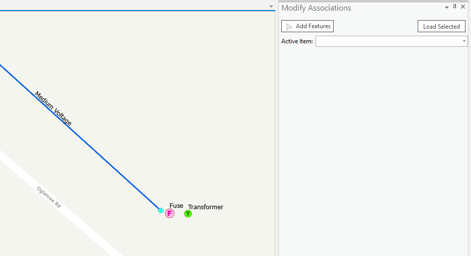

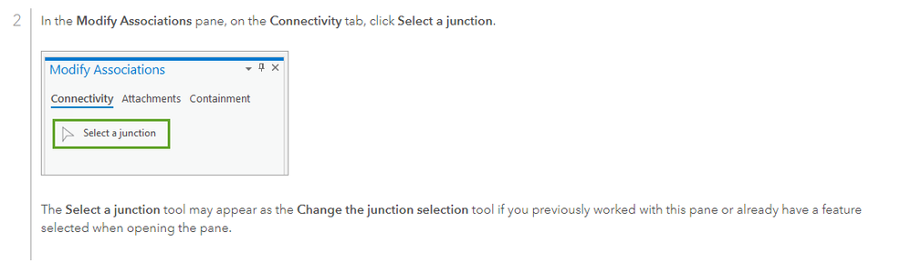

I'm working through the Getting Started with ArcGIS Utility Network Lesson (Get started with the ArcGIS Utility Network | Learn ArcGIS) and keep running into an issue in the Explore Connectivity Associations  section. This is my second time trying to get through the lesson. The instructions in step 2 state to click on the Modify button in the Associations tab. There should be an option to either Select a junction or change the junction selection. My screen doesn't show either of these options. What am I doing wrong? I'm currently using ArcGIS PRO 2.6.2
Screen Capture of the Getting Started with ArcGIS Utilities Network instructionsScreen Capture of the Getting Started with ArcGIS Utilities Network instructionsWhat I see in ArcPRO following the instructionsWhat I see in ArcPRO following the instructions

Thanks for bringing this up. This is a result of the Modify Associations pane being reworked to support nonspatial objects for the utility network. We will work on getting this learn lesson updated for the updated UI of the Modify Associations pane.
You simply need to use the Add Features or Load Selected buttons in the pane to set the active item.
