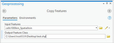

I am not sure about converting gdb to OSM, but you can convert your line and point layers to shapefiles as an intermediary step, using the Copy Features tool. Specify a file location for the output and add ".shp" to the end:
