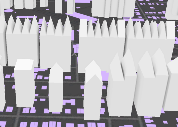

My other issue is with editing the 3D buildings once they are generated. For the buildings that I have generated, both with this version and the last version, I want to make them more realistic. My borough has many twin and row homes, and the roof forms generated often end up looking like this (in addition to no matter what I do, they will not sit on the ground):
The Roof Form Extraction Process page from the Local Government 3D Basemaps solution page describes editing the Roof Form attributes, but then doesn't explain how to turn the newly updated polygon attribute information into the multipatch feature class I'm looking for. I made changes to hundreds of buildings in the RoofForm polygon layer generated in the building creation process, but these changes don't modify the multipatch 3D buildings. The editing that can be done to a multipatch feature class is proving to be very difficult, and much more time consuming than editing the polygon attributes. This issue may be more user error than the program itself, but I am not finding any resources that describe how to make changes to, and then update the multipatch feature class that isn't manually moving vertices.
Please let me know if there's something I'm missing, but currently, though the process may generate less non-specific error messages, it's just as frustrating.

If you want to manually edit multipatches, you need to convert the polygons with rules. This can be done through the Fuse Roof Form Segments task in the solution template or alternatively use Layer 3D to Feature Class to create multipatches from a 3D polygon layer.
Regards gert

The borough I work for is less than 3 square miles, with the LAS dataset being just about the same area at a resolution of 1.5 feet. I did not have this problem of taking 8+ hours before the update. I was trying to run it again with a different projected coordinate system but after it ran for 6 hours, I had to stop the process, so I will be trying again soon.
I will look into the Fuse Roof Form Segments task and the Layer 3D to Feature Class tool for my other issue. Thank you!

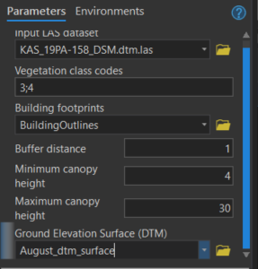

I was finally able to create acceptable multipatch buildings, but I'm running into an issue with trying to create schematic trees.
ERROR 010423: C:\Users\james\Documents\ArcGIS\Packages\LocalGovernment3Dbasemaps_B9FE7822-0621-4271-8E3D-FA3C4CA7C26B\p20\Intermediate.gdb\VegSinkRaster does not have valid statistics as required by the operation.
Failed to execute (SetNull).
I tried to run the Calculate Statistics tool on VegSinkRaster, but I'm still receiving this message. Is there something else I can do to get this task to work?
Thank you!

Hi Jen, can you share the parameters that you used? I may need to see a sample of your data to reproduce if you are able to provide it.
Thanks,
Dan

Here are my parameters. For buffer distance, and canopy heights, I just accepted the values it auto-populated.
Let me know if you want me to email you a copy of my data.
DanielHedges
Thank you Jen. It looks like you are using a straight LAS file as an input. Can you try adding that to a LAS Dataset and try again? If that still doesn't work, please send a sample of your data over, dhedges at esri dot com.
