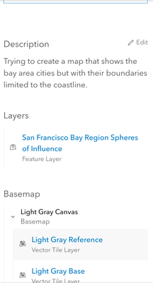

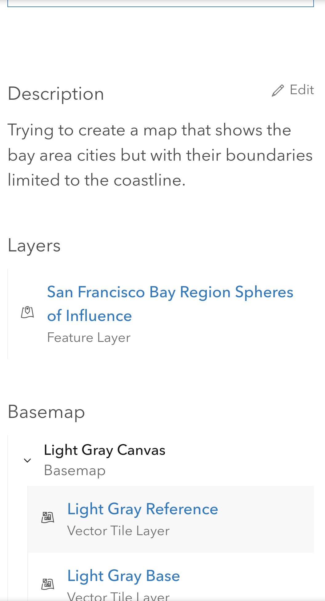

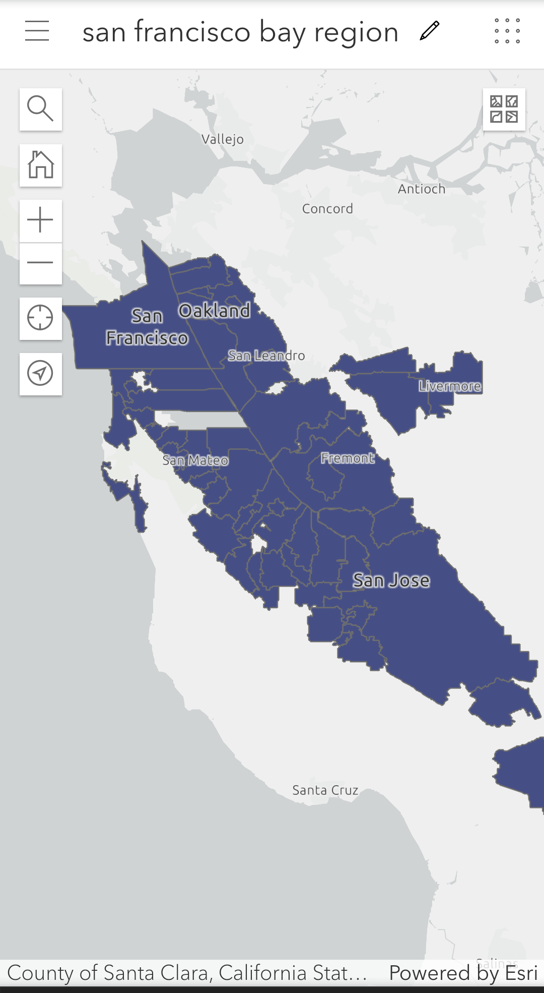

Hi everyone, I am trying to create a map that shows the cities of the San Francisco bay area. For this, I found a layer shown in the attached screenshot. I want to further refine this by limiting the city region polygons to the coastline. I also have a csv file that lists some numerical data for each of the cities. When I tried uploading it as content and bringing it into the map via tables, I didn't get the desired results.
I am still very new to gis, so any help to relevant tutorials would be really appreciated.

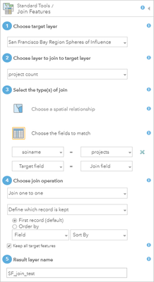

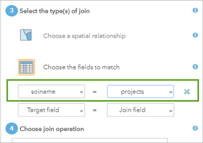

When you fill out the parameters for the join tool, in step 3, only choose one join field from each table: soiname and projects.
This part of the tool defines which are the matching fields. It does not define which fields to transfer. By default, all of the fields are transferred. You only need one pair of matching fields to make the transfer happen.
Try the tool again using the parameters I provide in the earlier screenshot (with only one field from each layer in step 3). The results I got look like this:

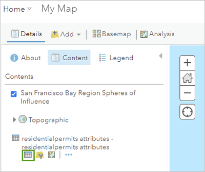

In the side pane, click Content. Make sure both your spatial layer (San Francisco Bay Region Spheres of Influence) and your csv layer are listed. If not, click the Add button to find and add them.
Under each layer, click the Show Table button.
In the tables, find a field that is common between both of them. For example, maybe your csv layer has a column that matches the fipco or soiname column in your spatial layer.

Fill out the tool parameters. Here is an example of how I filled them out:

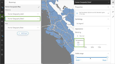

To limit the city region polygons to the coastline, the easiest method in ArcGIS Online is to hide the polygons under another polygon that represents water. You could search ArcGIS Online for a layer representing water in the Bay Area. You could also use a specific basemap that's useful in these cases:
On the Contents (dark) toolbar, click Basemap.
In the Basemap pane, choose Human Geography Map.
Scroll to the top of the pane and click Current basemap Human Geography Map.
There are three layers that make up this basemap.
Click Human Geography Detail. this is the layer that includes water areas.
On the Properties pane, change transparency to 0%.
Make sure that the Human Geography Detail layer is in the Reference section, not the Base section.
Now the water hides the city polygons so they appear to be cropped by the coastline.

I downloaded your .csv file and tried it out. I was able to successfully join it to the San Francisco Bay Region Spheres of Influence layer using these parameters:
Note that the csv table doesn't have all the same cities as the spatial layer, so not every polygon will receive a join.
I checked the "Keep all target features" box to make sure that the new layer contained all of the polygons from the old layer. If you don't check that, the new layer will only contain those polygons that received joined fields.

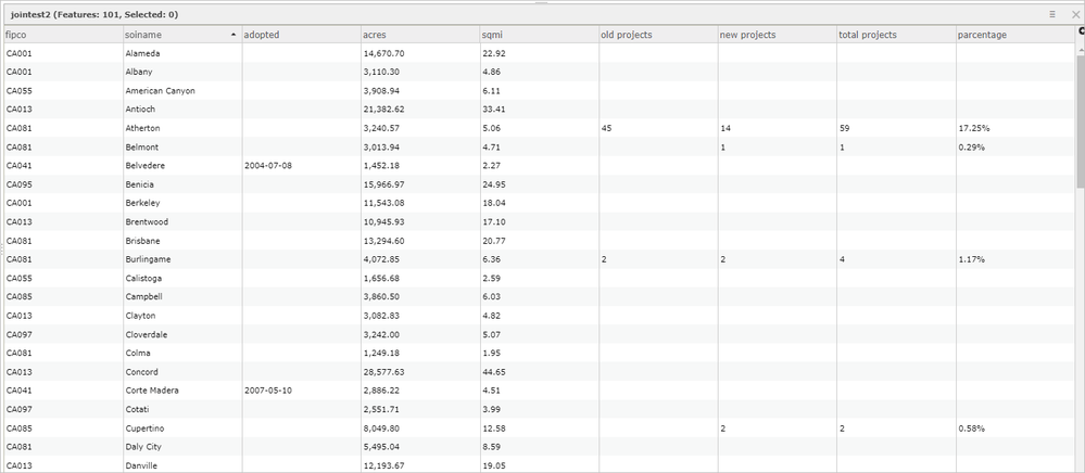

I was able to successfully use the join features on my csv file, and I tried running it per step 3 by choosing across different columns between the two layers. I picked soiname from the "region spheres" layer and projects, total projects, and percentage from my own csv.
the resultant layer is created with every column from my csv but without any of the values provided for each of the cities.
the percentage column does not get added through the join features.
What I want to achieve is to make a map that represents my projects by their percentages across the different cities.
If you can show me how to achieve that, I will be really grateful. I have attached a screenshot of the table from the layer i created that has empty columns.

projects mapprojects mapI finally got it to work just as I wanted it. Sorry for the late response. got swamped my work. Thank you so much for all the help along the way for this little project. The result helped me save tons of hours of mindless cleanup work.
