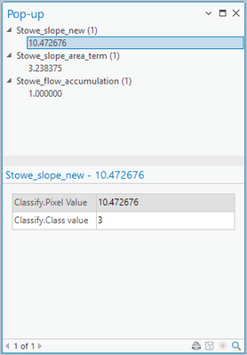

I'm sorry to hear you've been having trouble with the lessons.
Could you cross-check in the pop-up if the values are in float:
Eg
