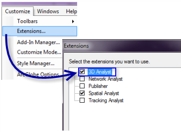

Adding to Dan, the license of 3D Analyst extension needs to be purchased additionally(if not yet purchased). Then you could use the extension along with any ArcGIS Desktop license level.
Once the license is available, you need to enable the extension from Customize > Extensions in ArcMap.
