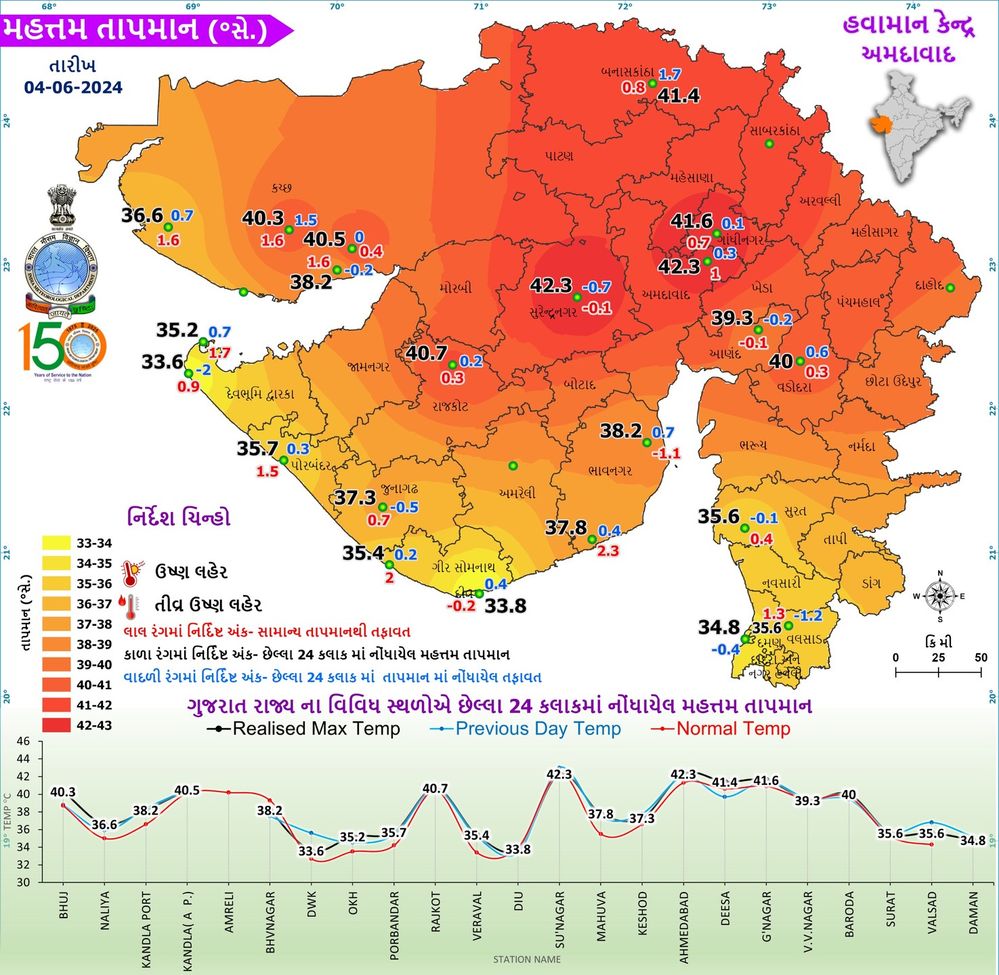

Can someone help how to replicate this graph?
975
06-16-2024 10:30 AM
Noob
Hello,
I found this Map intresting , I am unable to replicate the chart in this map can someone help me with it?image.jpg

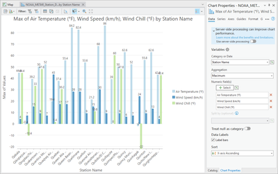

Hello @Noob ,
There's an example of creating a line chart in ArcGIS Pro at the start of this tutorial: https://learn.arcgis.com/en/projects/model-water-quality-using-interpolation/
You can find more instructions here: https://pro.arcgis.com/en/pro-app/latest/help/analysis/geoprocessing/charts/make-a-chart.htm
Here is a line chart that I made that is similar to the example you provided:
I checked "smooth line" and "label lines" to match the appearance of your example chart.
This chart has time along the X axis instead of station name, like in your example. To have station name along the X axis I recommend making a bar chart instead of a line chart, like so:
