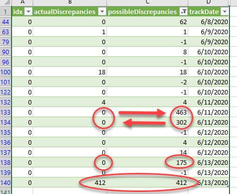

Like I mentioned, I don't have a sense of frequency just yet but I do have some monitoring tools setup.  This duplicate issue has only happened about 7 or so times since I started monitoring about 50 ESRI Tracker users collecting roughly 30,000 tracks each 24hrs.
I have a daily summary metrics that I am querying against the ESRI Tracker Service and the Hosted service I have moved points into from the tracker service.  In the instances where there's both a "actualDiscrepancies" and "possibleDiscrepancies" values then these are cases where valid ESRI Tracker features were created much later after the copy process ran and these are true discrepancies that I recover those points.
Whenever "actualDiscrepancies" = 0 and "possibleDiscrepancies" > 0 these are all instances where the ESRI track points were created later but already had created a point at the earlier time, hence it's a duplicate feature.
I'm only interested in the actualDiscrepancies and have a process in place to move these into the destination feature service after-the-fact.
(the -1 values are likely due to a missing ">=" somewhere in my programming that queries the feature services but I consider this quite minor and I simply ignore at the moment until I can find time to remedy it).

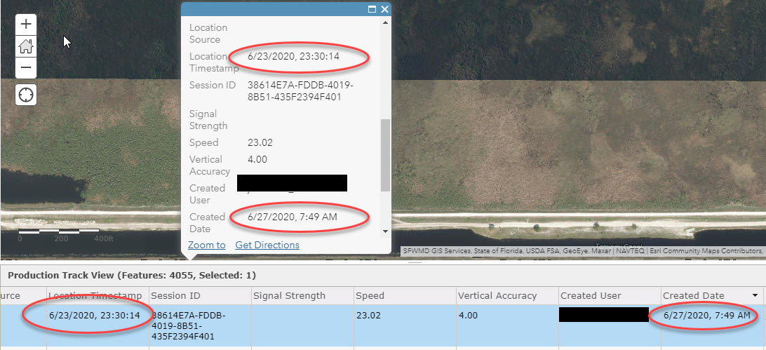

We're now seeing a much larger lag/delay in some instances and trying to determine if this is an app setting, device/OS type, connectivity issue or if there's something on the ESRI side of things that may cause this?  Recently we noticed a specific instance with a 4 day delay between location_timestamp and created_date:
by Anonymous User
Not applicable
We just updated the doc today:
Use tracks—Tracker for ArcGIS | Documentation
4 days is definitely abnormal. It's most likely a connectivity issue.
