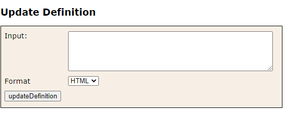

mcj5533
There is nothing currently in the Input box.  Should I just add in the parameter you have listed?
by Anonymous User
Not applicable
Yes, it will only update the one property.
