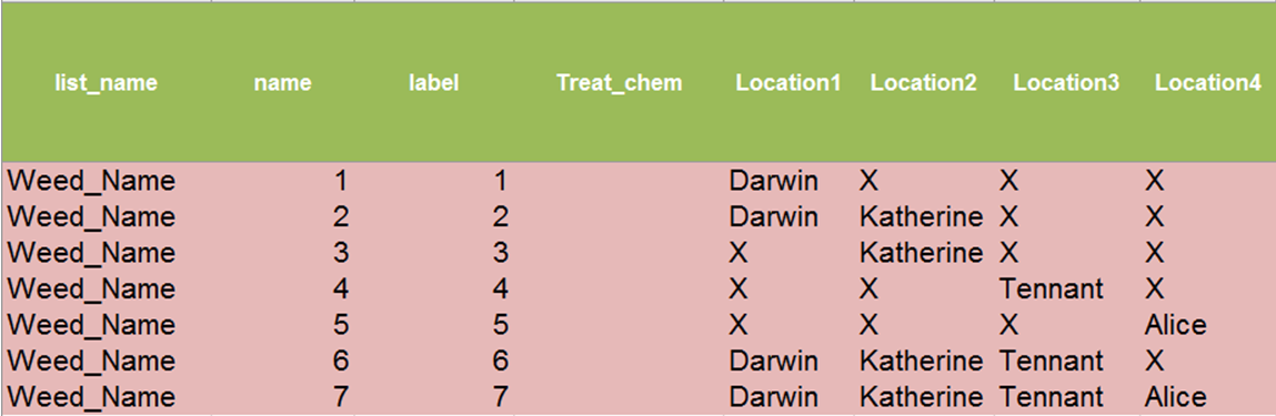

I am currently having a problem to establish the XLSform. Below is the description of problem.
If there is a number of weeds with few locations as where they exist, how to take out the weeds I need by selecting multiple locations with ignoring the other locations in one row/command?
Take 2 scenarios for example.
Scenario1 - I need to have all weeds located in both Darwin and Katherine, having weeds 2, 6 and 7 selected with ignoring the other locations.
Scenario2 - I need to have all weeds located in Alice Springs, having weeds 5 and 7 selected with ignoring the other locations.
Above two results should base on the same row/command in "choice_filter" column. With these limitations, how to input into "choice_filter" column of "survey" tab to make above 2 scenarios happen by using "and" or "or" or other possible functions?
weed location
If anyone knows about solution for the question, please let me know.
Thanks in advance
Howard

HowardWang1
Hi James
Thanks for reply.
But I need the choices for selecting multiple location"s" at the same time instead of just one location. The XLSform that you attached is using "select_one", but it might need to use "select_multiple" and should also work for above 2 scenarios. When using select_multiple, it becomes tricky as I cannot just use "or" to fit above 2 scenarios together.
Cheers
