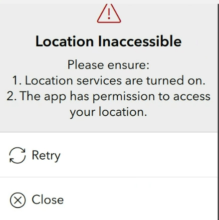

A user is reporting "Location Inaccessible" on a windows 11 machine.

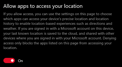

Typically, I'd have the user go to "Location privacy settings" and check off "Allow apps to access your location". That has already been done and the issue persists.

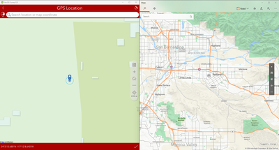

Hey @abureaux
Thank you for testing! Just to confirm when the behavior is observed and Survey123 isn't reporting a location at the same time is Windows maps reporting a location? Or is it if Survey123 isn't reporting a location Windows maps also doesn't report a location?

We've had issues with this as well (on Windows 10) with our virtual machines and AppVolumes where when a user opens Survey123 with the Allow apps to access your location setting turned on, it can't find the location (it might briefly, but then tries again and loses it), but thinks it can because it has access, and then spawns an endless cycle of the Location Error message rendering the app unusable.
Luckily the surveys they're using on desktop don't require location, so we've been telling users just to turn off Allow apps to access your location to use the app (though the Instaclones default it on, so they need to change this setting every day they need to use Survey123, which isn't ideal but that's not an Esri issue).
