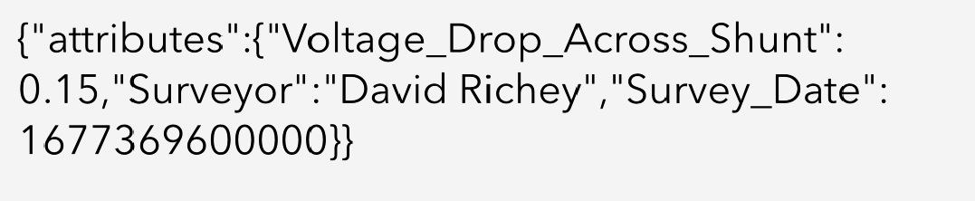

I am trying to display a table in a Survey 123 form showing the last three values collected for questions on the form. I'm using a version based on Ishmael's examples at  https://github.com/IsmaelInRedlands/Survey123-Tricks-of-the-Trade/blob/main/getLastSubmittedRecord.j.... I have gotten to the point of displaying the Json return in a null notes field, but it only displays the first record. The max record return for the service is the standard 2000. I have tried asking explicitly for a set number or leaving the &resultRecordCount= parameter out. Any thoughts on why only one record is returned?

it returns
Thrilled to get the most recent record based on the descending sort on object id, but really would like all three records I know exist.

DavidRichey_EWEB
This is my first time deploying a script with S123 or writing a JavaScript function to begin with. So, my hunch is that the JavaScript does not update fully unless one drops out of the S123 app and re-launches. I had been updating the survey with each edit to the script, but not seeing responses in the return. once I dropped out of the s123 app entirely, and relaunched it, the changes appeared. Thanks to  Neal-Kittelson for getting me to throw a brick at it.
