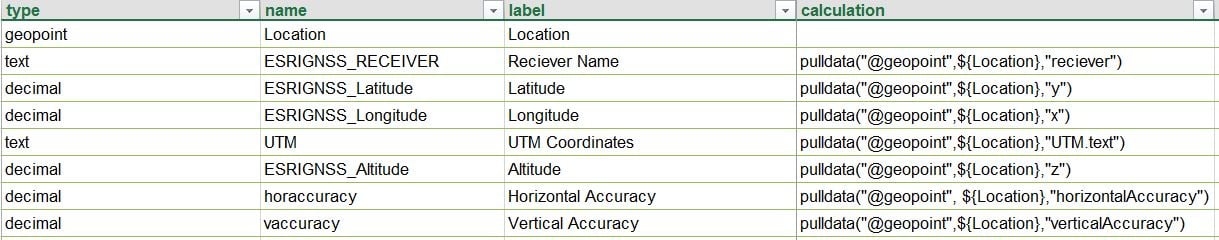

My survey is set-up to collect the geopoint, see the below table.  I'm using a Trimble Catalyst to get a more accurate location within 1 meter. However, when the survey pulls down the data it's incomplete and not totally correct.
Survey123 geopoint information in XLSForm spreadsheet

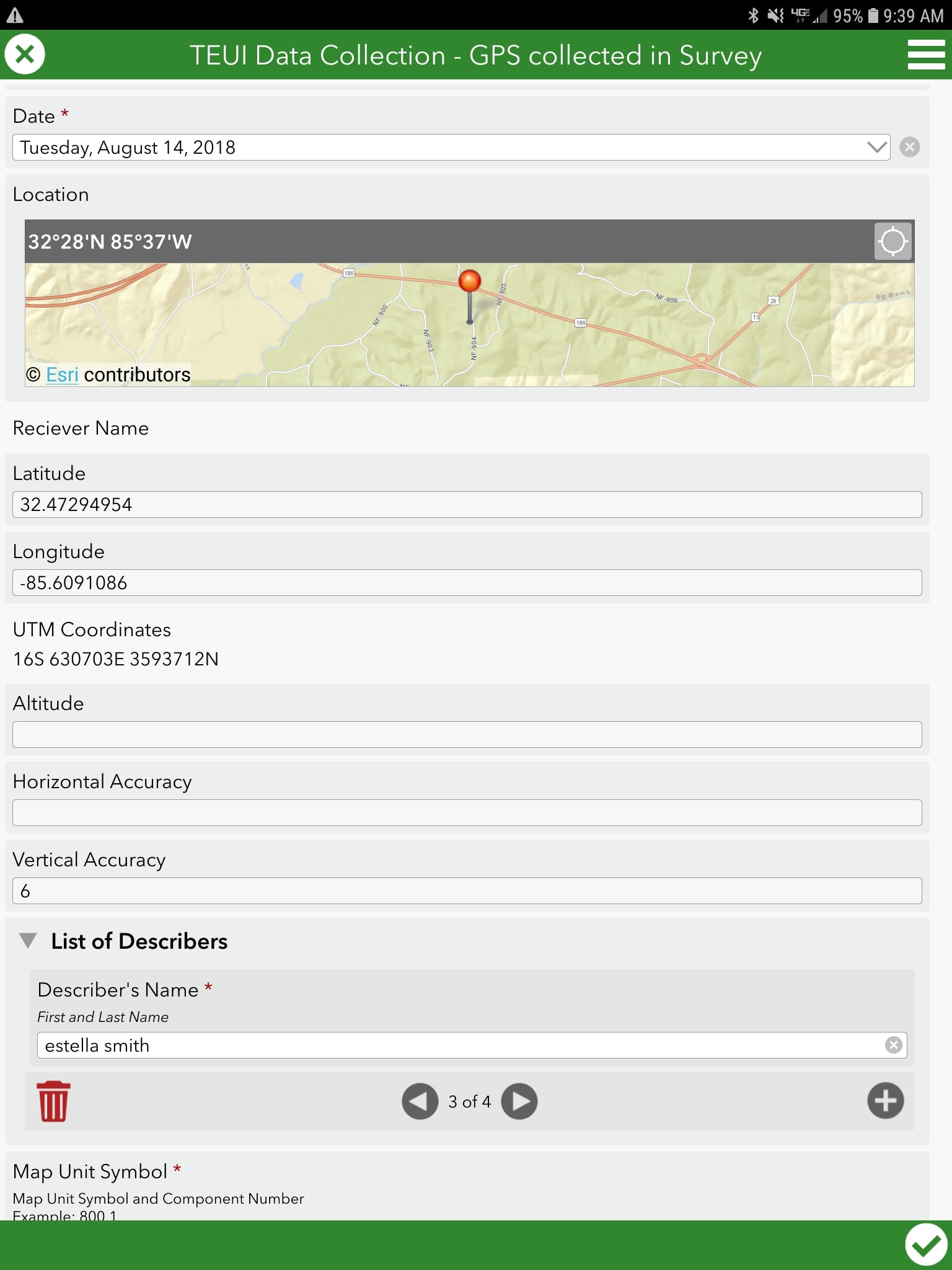

Below is how the data looks in the Survey123 App when collecting the location in the field. It shows it's not pulling down altitude and horizontal accuracy data.  So did I do something wrong with the calculation field?
Survey123 geopoint information in Survery123 App

Any suggestion on how to fix the pulldata information.  Why is it not pulling Altitude and Horizontal Accuracy from the geopoint?  Why is the latitude and longitude data being cut off in AGOL and not matching what is being collected in Survey123? Why is my UTM Zone incorrect?  Finally, how do I these issues?

First, to confirm, you are using the Trimble Mobile Manager app as the mock location provider in Android and that you are using a relatively recent (since December) version?  Survey123 does not connect directly to the Catalyst; instead, it relies on the system location provider to receive it's location.
With regard to the UTM coordinate, 16S is the correct zone & latitude band (not hemisphere) for the coordinate.
EstellaSmith
Yes, I have the Trimble Mobile Manager app on my Samsung tablet. I made sure it was connected before I collected my point in Survey123.

I just did a bit of testing with a Catalyst.  Survey123 was able to read the location and accuracy information from the Catalyst.  A couple of things I noted as I was testing:
- Make sure that Trimble Mobile Manager has been set as the mock location provider.  It looks like there are some issues with Android's UI in setting it as the mock location provider (see Unable to set Trimble mobile manager as Mock lo... | Trimble ), I found it easiest to remove the other applications in the mock location provider list to test
- In addition to setting the mock location provider, there is a separate switch in the Trimble Mobile Manager app to enable sharing of location - ensure that is set to on as well.
