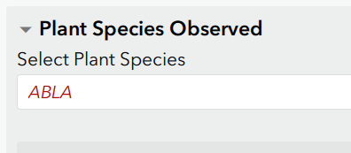

When using the search appearance label values disappear and the name value is shown instead when going backwards in the repeat
1598
03-14-2022 04:34 PM
DougBrowning
MVP Esteemed Contributor

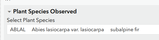

Using search appearance you pick a choice and it shows my label.  This is a csv in the media folder.
autocomplete search(${SpeciesListName}, "matches", "Plants", "Y")
But when navigating back in the repeat it is going to the name value and turning it all red
Users think the red is an error - since we taught them that - and now they are confused.
Why is it doing this?

Hi @DougBrowning,
Is the select one text field above an autocomplete appearance and also inside a repeat? If so, I believe the problem is the same as the one identified in this post:
https://community.esri.com/t5/arcgis-survey123-questions/select-one-appearance-autocomplete-in-repea...
We are aware of this issue in latest 3.14 release and are looking into it.
Regards,
Phil.
DougBrowning
Yes it is autocomplete and a repeat.  thanks  does look the same as the other post, I had seen it but did not catch the red in that image they had.
