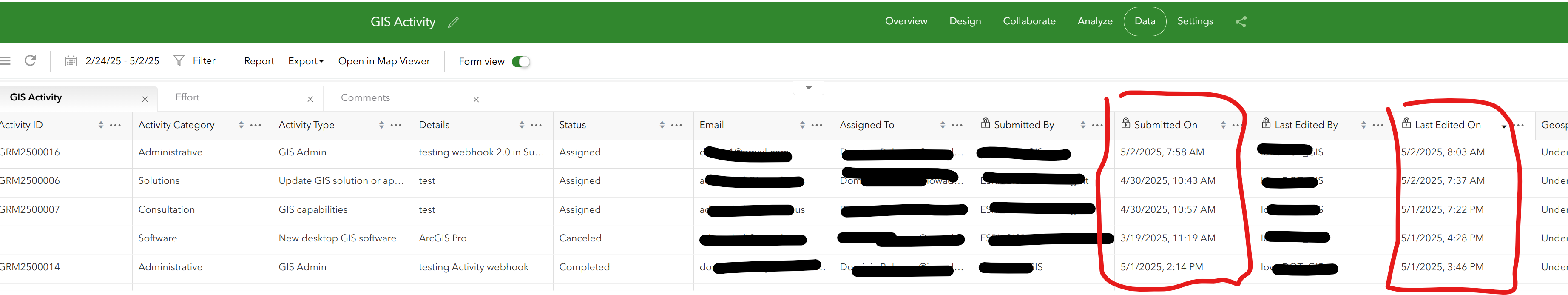

TylerGraham2
You might try checking some of the additional Event data boxes to see if one of those includes the submitted on and last edited on fields because while those are in the feature service, they may not be considered part of the submitted record because those are handled behind the scenes and not part of the survey itself.

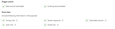

j-bromp
try checking all of these:
I just checked one of my payloads and i have created_date listed under the attributes:
I have them all enabled on mine:

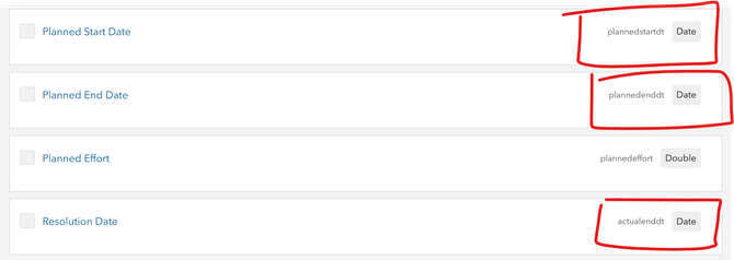

DominicRobergeIADOT
well... never assume the obvious....
One issue was that the date fields were NOT included in the Survey (my bad I should have checked that first..I am taking over from a co-worker)....

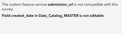

But now, when I try to add these fields in the survey (read only) I get the following:

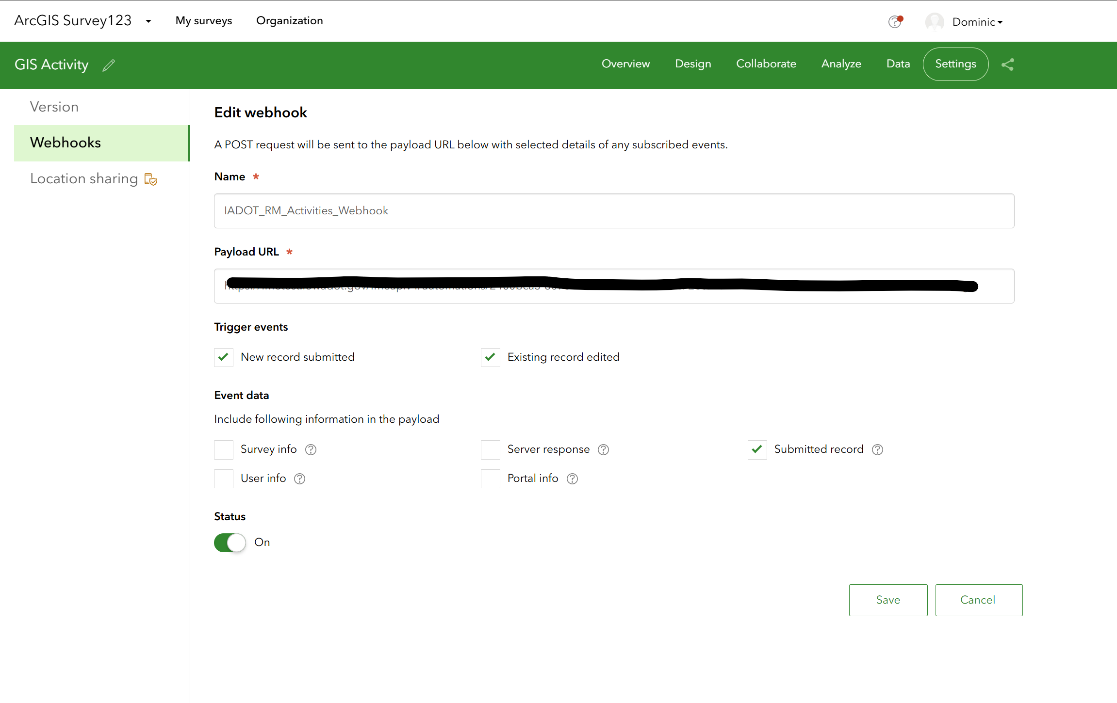

I did enabled all the options listed above , but still no go.
@j-bromp , how to you have the Created_date field setup in the Survey Connect?
TylerGraham2
You can't add fields to a survey created from an existing feature service when publishing updates.  You need to go to the feature service either in the AGOL environment or in ArcGIS Pro and then add the field to the feature service.  You'll then be able to reference it when designing your form.

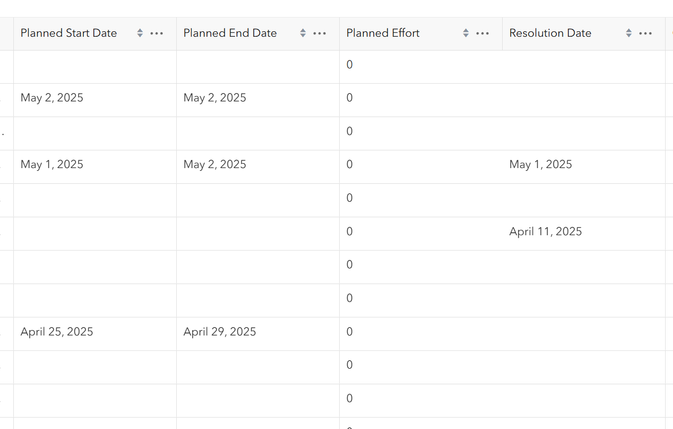

DominicRobergeIADOT
well I know that, I enabled feature access on the feature service with the following options:
I have the fields in the the feature service with values:
If I don't add them to the survey, they are not returned in the payload.

j-bromp
@DominicRobergeIADOT ,
you might need to change the submission url in the settings tab of the survey to something like this:
https://yourPortalUrl/server/rest/services/Hosted/service_yourService/FeatureServer
I have a bunch of date fields in my survey actually, one is a dateTime field that defaults to now(), and the others are utc offset corrections and formatted versions.
