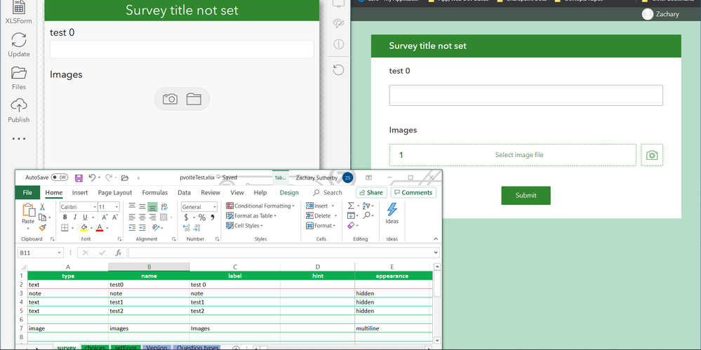

Hi all,
I'm using Survey123 connect to build a form on the field app and it works great ! I would also like to be able to use this form on the Web app but i'm facing the two following issues :
  1. i've got hidden fields (appearance : hidden) on the form that I use for later analysis. They're correctly hidden on the field app but they are visible on the web app. Is it possible to hide them on the web app too?
  2. i've got an image field with appearance : multiline to capture/browse multiple photos. It works great on the field app but a text field is displayed on the webapp. Is it possible to have a browse images function instead on the webapp?
Thanks,

Hello @pvolte
I had tested on my end and I was not able to reproduce the same behavior:
Is there a specific browser where this behavior is observed, or is the behavior observed in all browsers? Is the survey using the latest 3.11 version on the settings of the survey?
If the survey is using 3.11 and the behavior is reproducible in all browsers would I be able to obtain a copy of the XLSForm for testing on our end?

pvolte
Thank you very much, the whole problem is solved by switching to 3.11. My form was on the 3.1 build. Is the form build related to the version of survey123 connect?
