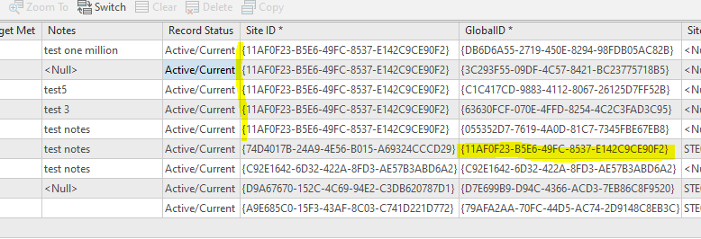

Here the data in my child table during testing, you can see it keeps using the first GlobalID for that site for all the subsequent sites.

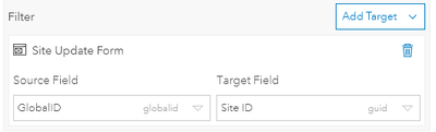

This is the filter I'm using on my dashboard list:
It will not let me create a child record if the parent doesnt already have a child record against it (I assume because it needs that first GlobalID *face palm*), so the form just says 'No Data' and doesnt present the form for the user.

It sounds to me like you are using your child table as the data source for your embedded form.
List Widget Data Source: Parent Table
Embed Widget Data Source: Parent Table
Survey URL: Survey pointed to Child Table
The URL parameter of the survey is where you actually move the Global ID into the Site ID.
&field:SiteID={field/globalid}
