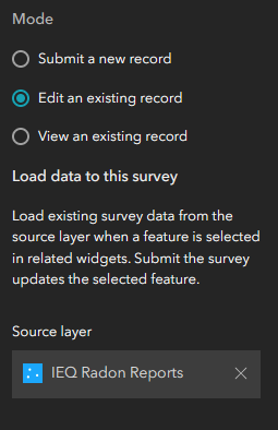

abureaux
MVP Frequent Contributor
As the error says, GID was not provided. Either the survey wasn't set up properly in EB, or your permissions are wrong. Double check both these items.
Where are you seeing the error though? In development, or in the deployed app.
Regarding survey set-up, it should be pretty straight forward (Example below). In this case, simply selecting an item passes along the GID because "Edit an existing record" is selected. Everything else is automated.
Also check that the account accessing the EB site has permission for the survey as well.

abureaux
How is the survey set up in EB? If it is like my screen shot, and set to "Edit an existing record", then the GID is automatically added when you click on a feature in the web map.
Are you sure that the survey being used and the data displayed no the web map are the same? The data displayed on the web map should be the same data the survey is built on top of.
EdHixson
Hi there
Yes the survey is set up the same way and it is when the "edit an existing record" is chosen that the error screenshot appears. I have been investigating further and this seems like I may be due to data not appearing in the map which is being caused by another issue. Once I hav got this resolve I will come back to this thread to discuss further
