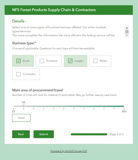

NFS Forest Products Supply Chain & Contractors - Design - survey123.arcgis.com.jpgNext not choice when 2 or more selected.
Building Forest Products Industry resource for people to find a contractor or sawmill, etc. First page gets name, address, etc. The supply chain consists of these 5 types of businesses. Some people do more than one task in the chain. But I don't want a Maker to have to scroll past 3 other sets of questions to fill out their specifics. It worked as a build in Survey123 Connect in the app, but not on web where it needs to be. I rebuilt in the web designer. Made each biz type a group with visibility based on answer to biz type. Didn't work if multiple types selected. Made each type a page. Doesn't work if multiple types selected.
Please advise. Read a post yesterday someone said they could do it in web designer and not Connect but I can't figure how to do it in web designer.
Thanks!

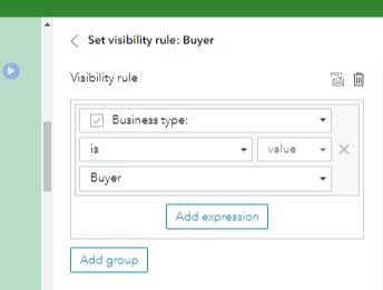

VisibilityfilterNFS Forest Products Supply Chain & Contractors.jpgRule same for each type "is value" x

I can input one business type. If I select 2 as in picture above it goes to submit instead of next.
Visibility rule on every question on every page related to the business type.
