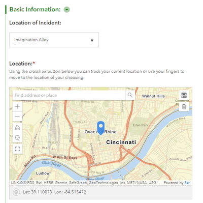

Hey there,
Thanks for adding your .csv and form! Helped a lot. I seem to have it working on my end in both S123 Connect and the corresponding Web Form.
The changes made were the following:
CHOICE LIST
  • This one was a simple fix! In the choices worksheet, I changed the name of column D from 'Incident' to 'Incident_Loc', then updated the choice_filter formula in cells O8 and O17 to be selected(${incident},Incident_Loc).
  • I have a feeling S123 was getting the choice filters mixed as the first question is named 'incident' and there is also a list_name on the choices worksheet named 'incident'. Giving it a unique name seemed to work.
GEOPOINT QUESTION
  • In this case, the locationCal calculate could actually be simplified. From Ismael's example here, he used the substr() function as he was pulling from a value that had the full coordinates in it. As you're pulling data from the csv for the lat and long individually, you actually don't need a substring calculation.
  • One of the things I did to troubleshoot was add a null note question for the locationCal to see what was being generated. In S123 Connect, this looked fine. However in the web form, it returned an NaN value.
  • I changed the calculate as seen below and that seemed to work:
    • substr(${latCal},0,12)+' '+substr(${lonCal},0,13)
      to
      concat(number(${latCal}), ' ', number(${lonCal}))
  • The geopoint question called ${locationCal} as before.
Hope that works on your end too!

3CDCOrganizationalAccount
First off @Vinzafy thank you so much for answering my question! That was a big help and everything is working now in that survey.
I have another similar question I think because I tried to change another survey where I used substr(${latCal},0,12)+' '+substr(${lonCal},0,13) and now I am having similar issues with this survey where the XLS form is not pulling the CSV information we need from a list of local businesses that our staff check in on.
The specific part that is not working is the pulling lat and long for the geopoint question after you answer that it is a business check. I added some notes to see if it was pulling the data at all and was not able to get any information from the file.
Its weird because the only thing I changed was substr(${latCal},0,12)+' '+substr(${lonCal},0,13)  to concat(number(${latCal}), ' ', number(${lonCal})) and I added a few choices then the pull data calculation stopped working...
Any help is appreciated!
