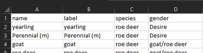

Edit: Since Method #2 is probably what most people will be looking for, I should probably elaborate on a couple things in case others find this post.
  1. I named my CSV "test"
  2. When you convert a list in S123 into a CSV, you exclude the "list_name" column. This is the result:
  3. You can learn more about pulldata() here.

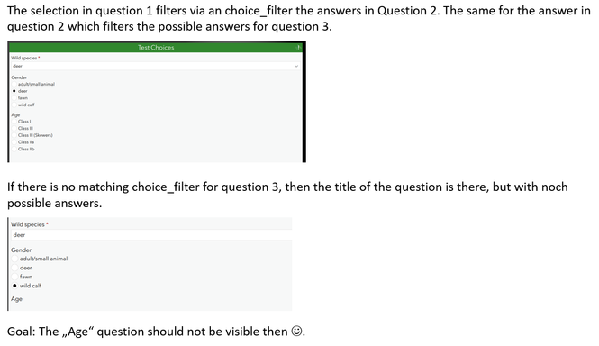

I have attached the excel file. Here is a description with pictures:
The use case is the following: The customer records different wild animal species that have been hunted in the field. To do this, he first selects the wild animal species (question 1). Then the subspecies or sex is selected via a choice_filter (question 2). There are also age categories for a gender (question 3). A choice_filter is also used here. The challenge: There is not an age description for every sex/subspecies. In those cases, no answers are offered for question 3, but the title of the question remains there.
