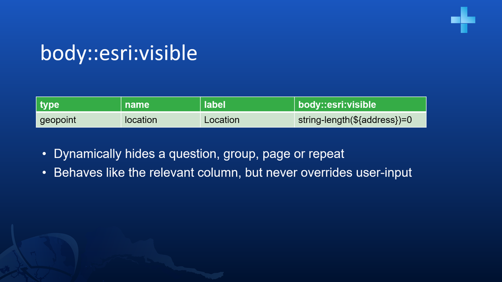

@CN wrote:
I'm thinking this is likely possible but not sure on the syntax.  Say one has two S123 groups, I would like both to be set  to  the appearance "compact" at load but would only want 1 group open at anytime.  So if group1 is expanded, group2  is compacted, if group2 is open, group1 is compacted.  Any assistance is appreciated if supported.  Thanks.
Tip: If you move your relevant expression to the body::esri:visible column, you will control the visibility of the question without affecting its values. When a relevant expression is false, the question is hidden and nulled-out. When that same expression is moved into the body::esri:visible, the question is hidden, but the values will remain untouched.
For more details see Question visibility section in this help topic.

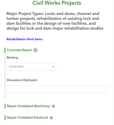

CN
Thanks for the info Ismael.  Just to be clear for this particular survey, i do not want to hide groups rather just collapse them(the appearance compact setting)...see screenshot below.  If nested concrete repair group is expanded i want the rest to be collapsed.  I only want the current nested group to be open.  Is this possible?  if so i'm intently listening.  Thanks.
