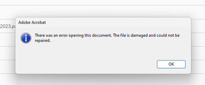

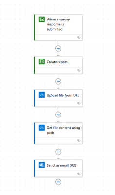

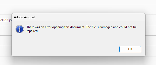

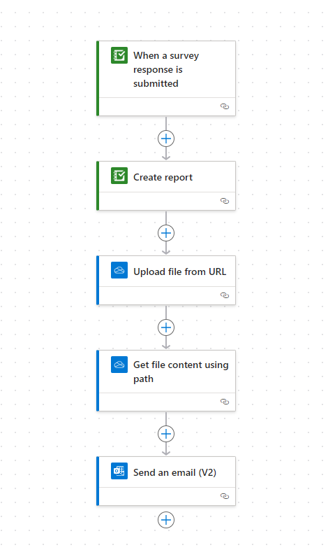

I am having a problem setting up a Power Automate Flow to create and email a Survey123 Report.  Having never done this before, I've set up this flow based on what I could find online in the various blogs.  The first 3 parts works fine. It will create the report and uploads it successfully to one drive.  I can even open the pdf from there.  Problem is when the reports gets emailed as an attached pdf, you can't open the pdf.  All you get is there error.  I'm at a loss as to what the issue is here.  Does anyone know how to resolve this?

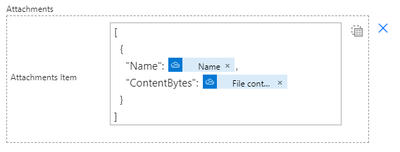

Can you expand the details on the email action? This is how I have it set up to sent the attachment in my flow.

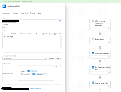

Robert,
Mine is set up the same...

The only thing I notice different is that around the dynamic content elements you have quotes, where as in mine I do not. I wonder if that's making the difference?
