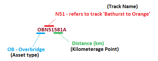

I would like to use something similar to Excel expression, "LEFT" function, to refer to part of the Asset ID which will then automatically populate subsequent fields.
For example, as shown in the diagram below for Asset ID OBN51581A

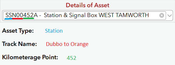

How can I structure the XLS form to get it to calculate or lookup the specific string from an Asset ID so that I can
and bring up the corresponding 'name' field listed in the choices tab?

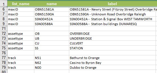

An example of my choices sheet will be something like:

I have managed a work-around by combining the calculate on the substr() function followed by pulldata:
Even though the calculate rows do not return physical results on the form (ie row 8 & 9), field attributes are still created in the feature dataset layer. Which means, I would essentially have three attribute fields returning same/similar results and are therefore redundant. Is there a way to prevent field attributes to be created for row 8 and 9 above?
