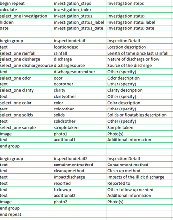

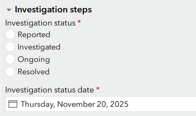

I have a repeat section titled Investigation steps with the following select_one options:
I have two sets of survey questions that I would like appear within the repeat section depending on what is selected for the Investigation status question - one set of questions if Reported or Investigated is chosen and another set if Ongoing or Resolved is chosen.
I have created two groups within the repeat section
and have set their relevant field to
selected(${investigation_status},'reported') and selected(${investigation_status},'investigated')
and
selected(${investigation_status},'ongoing') and selected(${investigation_status},'resolved')
However, the relevant group of questions are not showing up when I make the selection in Investigation status.
Any help would be appreciated.
Thanks!
Neal_t_k
change those "and"s to "or"
Right now they have to meet both conditions and you want one or the other.
Neal_t_k
dsinha
Thank you so much @Neal_t_k! That worked perfectly!
