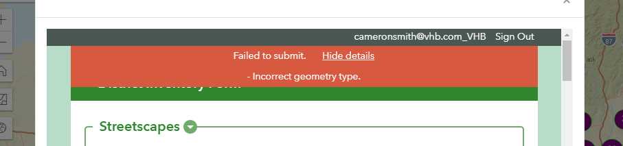

Hi,
I'm having an issue with the Web Form version of a Survey 123 Form I created. I created this Form in Survey123 Connect. I'm using the "GeoShape" field in the Form to allow for the capturing of a polygon. So GeoShape works fine in the Survey123 for ArcGIS phone app. But we also embed the Form in a web application that we have. We use the url like this: https://survey123.arcgis.com/share/1cb28b212b5542acbbdbaa35feba0765 and put that in an iframe (this is straight from the embed option on the collaboration page in https://survey123.arcgis.com). So here's the thing, I understand GeoShape is experimental, and I don't actually need it to work in the webform to create polygons. I would like to just hide it, and not make having a polygon be require. I tried to hide the field of type GeoShape using the "hide" query parameter. This worked to hide it in the webform, however when I submit I still get the following error:
Is there a way to get around this error for the Web Form?
Also, does anyone have any idea when GeoShape will be actually functional in the Web Form?
Thanks a lot!
Shwu-jingJeng
Hi Smith,
The error is expected as we currently do not support Line and polygon surveys in Survey123 website.
We do not have a specific timeframe to support line and polygon surveys yet but it's in our future release plan.
