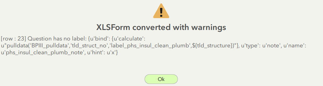

Hi James,  I have been trying as you described, but I can't seem to get the pulldata to work.  I have a note question and use the pulldata syntax/csv from my original post in the calculation cell.  I have to put in a a value in the label or hint or I get an error.  When I put a value in the hint only, I get:
If I put a value in the label only, I only get the value I put in, not the calculation.
Do you see any issues in the syntax of my pulldata function or csv?  Maybe even a limitation on the names used? Quotes issues?
