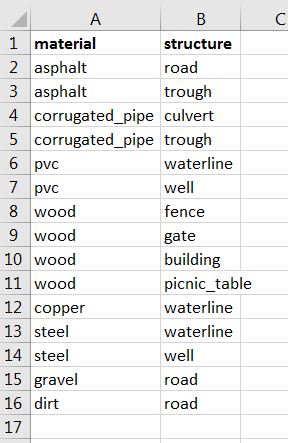

I'm using Survey123 Connect for ArcGIS v. 2.4.60 to create an asset survey form. I have several asset types that will ask "What type of material is asset made of?" Some materials are specific to an asset while other materials can be used to describe several different assets. Instead of creating 20 separate lists for each asset's material dropdown list, I would like to create a single materials list (see graphic) and have the chosen asset type limit the material choices to relevant materials. For example, the user selects the type of asset from a "select_one asset" list (e.g. road) and the corresponding "select_one materials" list will only contain materials used on roads (e.g. asphalt, gravel, dirt, etc.). Select waterline for the asset and the materials list will contain pvc, copper, and steel. If this is possible, how would I get started?
screen clip of materials list for all assets

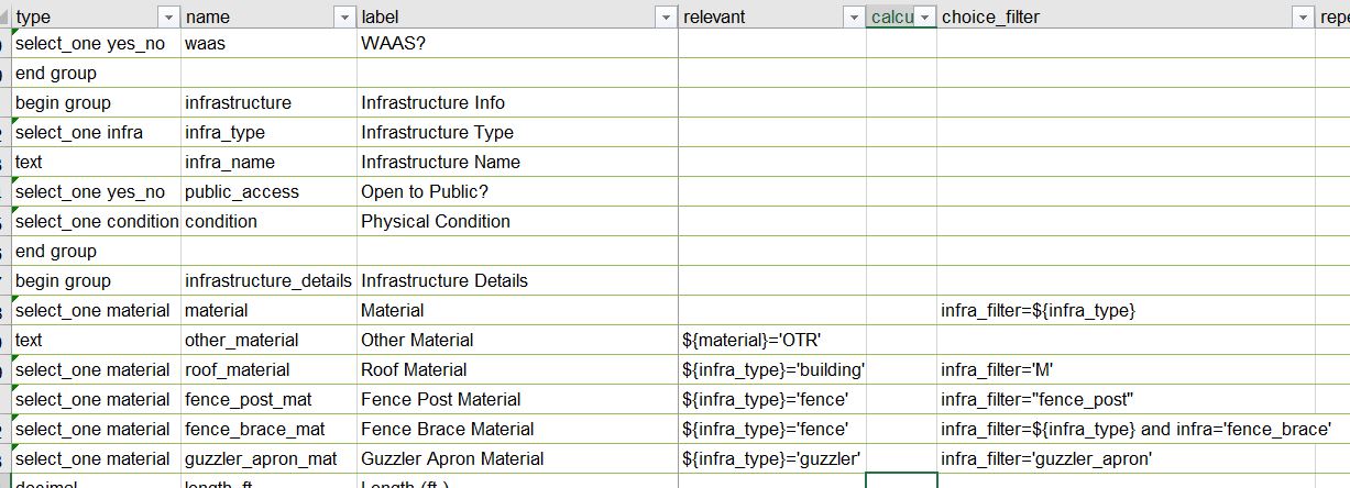

If the user selects "fence" for the asset, then the materials list populates with fence materials of "barbed wire", "chainlink", "hogwire", etc. Also because "fence" was selected, 2 new dropdown lists appear for fence brace material and fence post material. For the fence post dropdown list I already know that I only want to pull the "fence_post" materials from the master list. I've tried different syntax in the "choice_filter" column, but cannot get the list to populate on the form.
If the user selects "building" for the asset, then the fence brace and post fields disappear and the roof material field appears.
XLSForm example
What is the syntax for filtering a list based on a known value?

The choice filter currently cannot evaluate fixed strings such as infra_filter = "fence_post" .  In this context, it would make sense to create separate lists for each question rather than have one 'materials' list (which, admittedly, you wanted avoid).  Another method would be having additional hidden fields to provide the filtering capability (in your example a question called fence_post with a value of 'fence_post').
