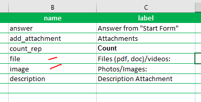

Hi Doug,
thanks for your answer. After a bit, I found the problem: if in the linked form there is a calculation inside a repeat with attachments, the mobile app crashes.
Please find attached the to forms. Start form is linked to End Form with an app link.

My guess is you used a field name of file for the file question.  That is a reserved word.  You also called image image which is not reserved but not good idea to use that.
I am also not sure count works when given a repeat name.  I think you need to give it a field inside of the repeat.
A number of your drop downs in excel are broken.  Make sure to always use Paste Values vs ctrl C and V or excel brings all the formulas over.
If it still fails turn on logging in 123 to see if there is more info.
