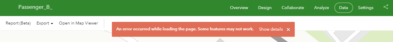

I need your urgent help because my people are supposed to go into the field within the next hours
After doing a pilot with our surveys A and B I receive for both surveys following error message when trying to access the data view:
"An error occured while loading the page. Some features may not work." When I click on Show details it says Data error.
I now created the surveys again based on the old files because I thought maybe there was something messed up while updating. Buuut, after submitting the first test survey I get the same error. I can still download the gdb but I cannot filter the results. The analyze tab also works fine. So what could be the issue with my data?

Unfortunately, to diagnose what the cause of the error might be, I would need more details on the form.  Can you share the XLS file?
Nicole_Ueberschär
Luckily the error is only appearing in Chrome (also after restarting and clearing the cache), not in Edge or Explorer and it seems like also only appearing for me. I will still send you my excel file privately.

i'm have the same issue when trying to filter a field that is a 'esriFieldTypeDouble' and trying to filter it where its greater than 10000
maybe it just see's it as a text field in the site, i've tried in both IE and Chrome

Managed to get it working, for some reason the field i was filtering wasn't visible in the stakeholder feature service for my survey, i updated the definition so that it was visible and it works with out error now
