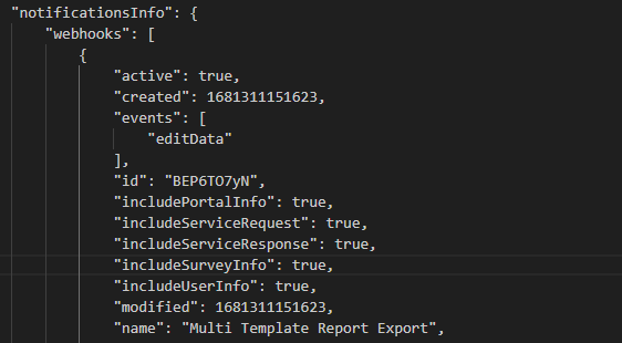

I am curious if there are any concerns with updating the .info file associated with a published form. We are looking to download form items and add an additional webhook to forms hosted in our portal environment (Enterprise 11.3). From reviewing the downloaded .info file, existing webhook definitions have an "id" included. Would we be able to just create a random id for this or are these values referenced elsewhere?
Additionally, for us to add an additional webhook this way, would we need to update anything outside of just this info file?
mattkramer
Following up on this. We were able to use the REST api to add a webhook definition to the .info file and reupload. We used the webhook definition from a form that already had the webhook we wanted to apply to all forms and copied that into the .info files for every form that did not have a webhook by the same name. After some testing, we found that forms were successfully updated and the webhooks on the affected forms seem to be working without issue.

As an aside, maybe a routine Python script which counts all published forms, and then counts all published forms with an "id" (indicating a webhook exists). Then you could create a list of forms that need webhooks added manually?
That would at least semi-automate the process, and avoid any potential mishaps from programmatically adding the id in.
mattkramer
I think that might be our best bet as well. I reviewed some of our cloned forms and can see that when cloning, the webhook id does not get updated (so clone id = original id) so we may try reusing the same id values. If that ends up not working, this is the route we will be going. Thank you for the help!
