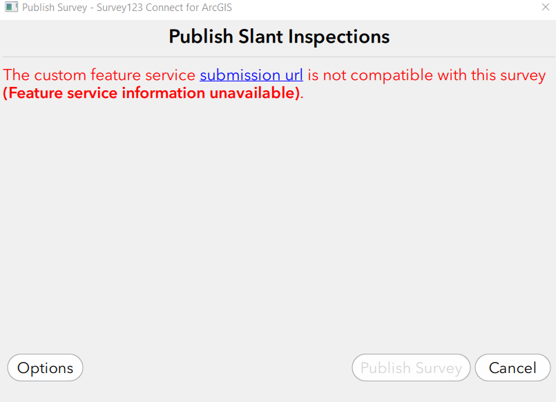

When trying to publish an update to a survey that is connected to an existing feature service using the submission_URL setting, I am now getting an error from Survey123 Connect that says the Feature service information is unavailable.
Has something changed with the most recent update to ArcGIS Online that prevents using an existing feature service with Survey123 as before? Here is the error message that I receive.

Hi Brian,
This appears to very particular to your survey & feature service - you may want to double-check that the feature service exists and is visible from the account that published the survey.  I would also go to the item details page of your form item- it should show a link to the feature service URL.  Is there anything else about the history of this service/form that could be unique?

  1. When I try to make a new survey in Enterprise using FeatureService2 Survey123 Connect never actually makes it, it just spins forever.
  2. If I make a blank survey and then attempt to manually set the submission URL to FeatureService2 I get this:

I also had this problem, but I found the solution (actually, the error was mine 🤐).
I usually point the submission_url directly to the layer's service URL, rather than in the standard "https://www.arcgis.com/sharing/rest/content/items/ITEM_ID" format.
However, entering the URL was also passing the layer's index within the service, which was causing the error.
Incorrect: https://services3.arcgis.com/bpW2aXmRSOnKTBmc/arcgis/rest/services/test/FeatureServer/0
Correct: https://services3.arcgis.com/bpW2aXmRSOnKTBmc/arcgis/rest/services/test/FeatureServer
