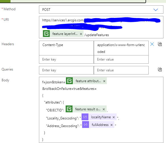

In my scenario, an http request is sent to the 3rd party geocoder API, and it retrieves the city and address information, and post it back to the feature layer.
I used 'pulldata('@property', 'token') to get the token information and used it in the update url (image below).

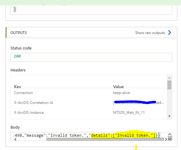

When I ran the scenario, it says it ran successfully, but two fields above (locality/ address) are still empty. If I check the output status in Power Automate module, it says  'invalid token'. The input area shows the values I expected to see.

Hi. The currently available version of the Power Automate connector makes working with tokens quite difficult. I suggest you wait a couple of weeks as we have a new release waiting to be approved by Microsoft. With the new update, you should be able to get the token from the payload, like you did with Integromat.
