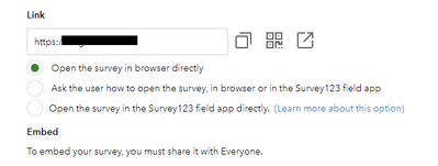

You need to share your survey with "everyone" in order to embed it, correct? (I think since v3.12?).  Does "keep  track of who created and last updated features" work with layers that are shared publicly?

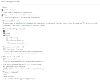

Both of these have changed since the last time I looked at them (and I'm not an enterprise user), so I'm not sure how to resolve your issue but this is where I would start.   First screenshot is the Survey123 settings on the survey123 website. The second screenshot is the "settings" page of the hosted feature layer on AGOL.
