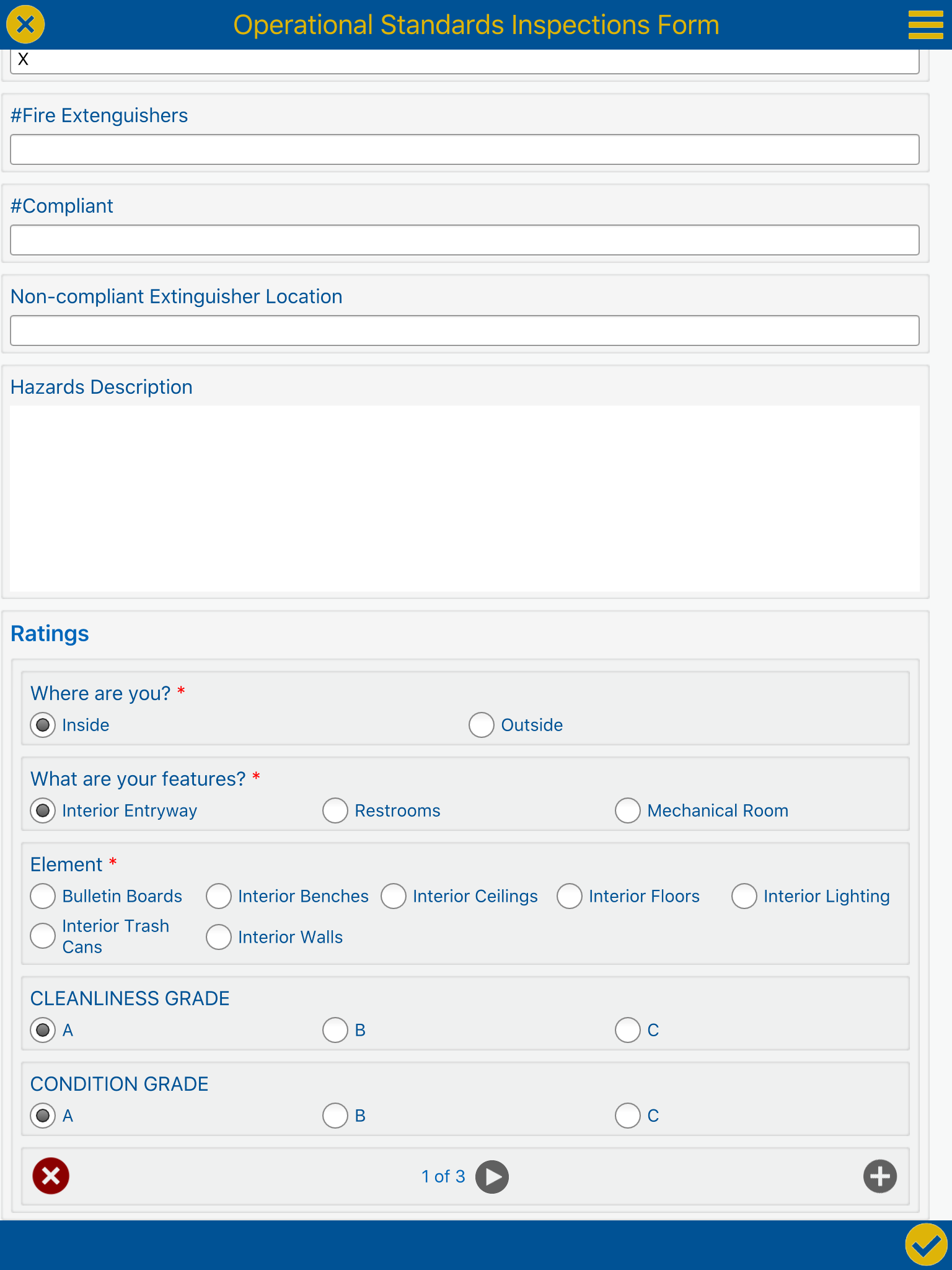

An issue arises when creating a new page and a different "area" or "feature" is selected, it erases nested data on previous pages. This issue can be repeated in three situations:
Situation #1- Input repeat data

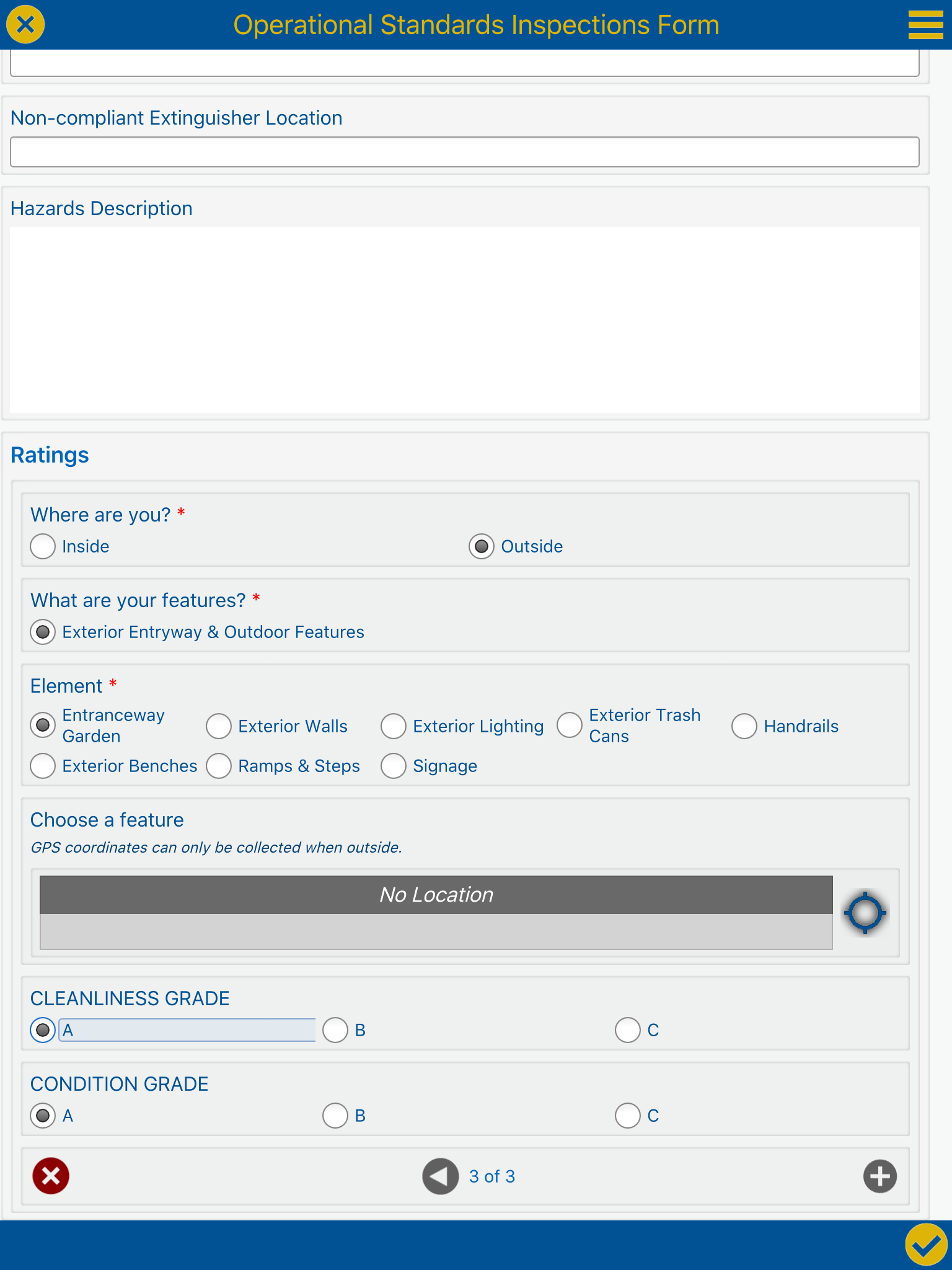

Once I have selected "Inside" for the initial layer "Area", I completed the rest of the questions under this cascade on the first page of my survey. Then, I add the second page of the survey. Working from the second page of the survey, I first select "Outside" for my initial "Area" field and continue to complete questions nested under the cascade. When I return to page one, the "Features" and "Element" fields are unselected even though they were previously selected.

*If you have multiple pages, going back one page will unselect  "Features" and "Element" fields. Going back two pages will unselect only the "Features" field. Going back additional pages will be normal; they will remain selected.

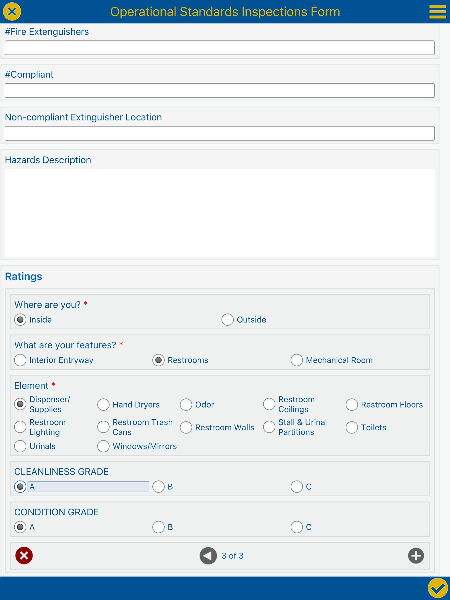

Situation #2- Input repeat data using new "Feature"
Once I have  selected "Inside" for the initial layer "Area", nested underneath, I have selected "Interior Entryway". Then, I add the second page of the survey. Working from the second page of the survey, I first select "Inside" for my initial field again. Next, I select a different option for the field nested under the first layer of the cascade (e.g. "restrooms" instead of "inside") and completed the rest of the question under the cascade. When I return to page one, JUST the "Element" field is unselected even though they were previously selected.*

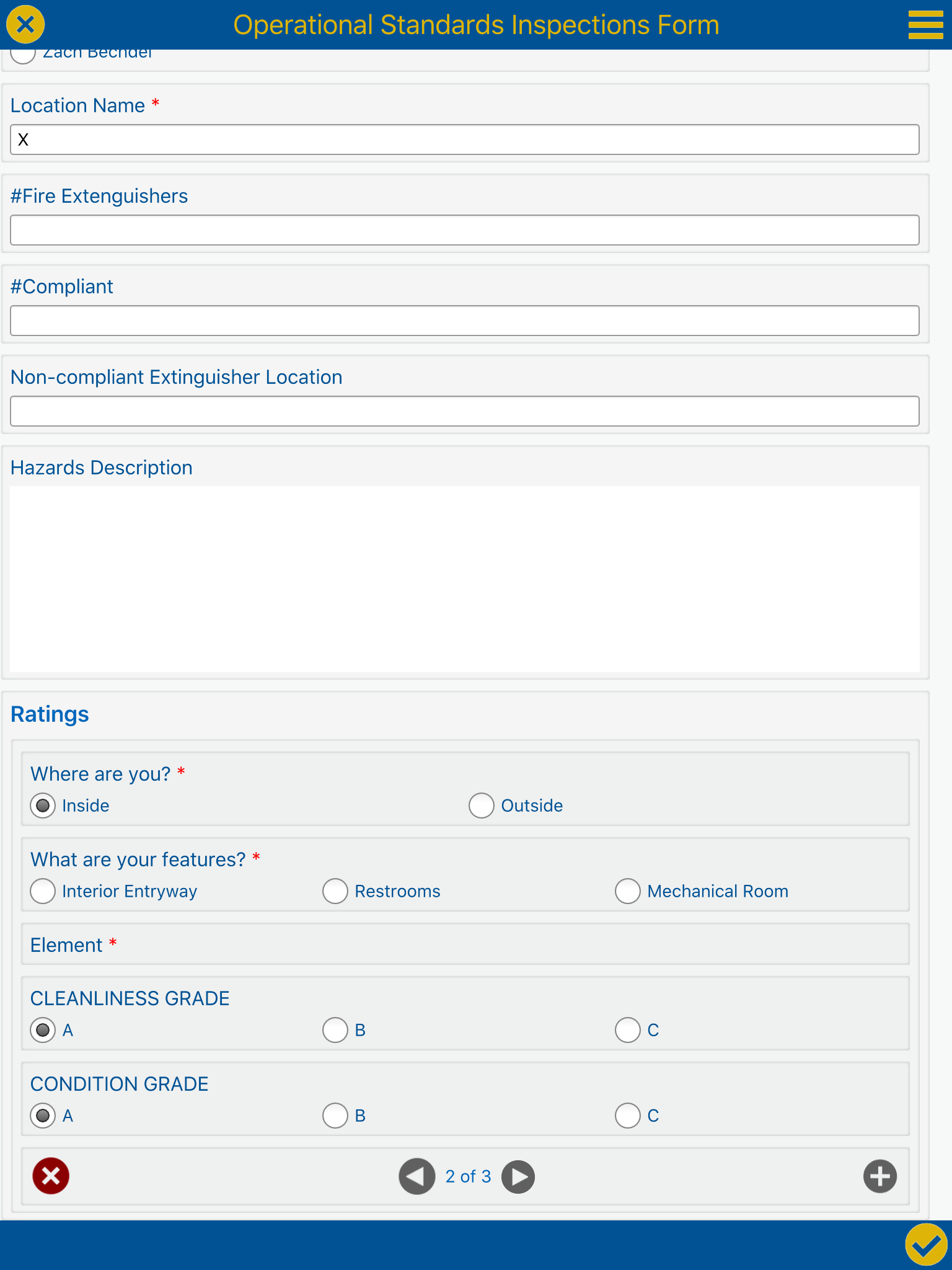

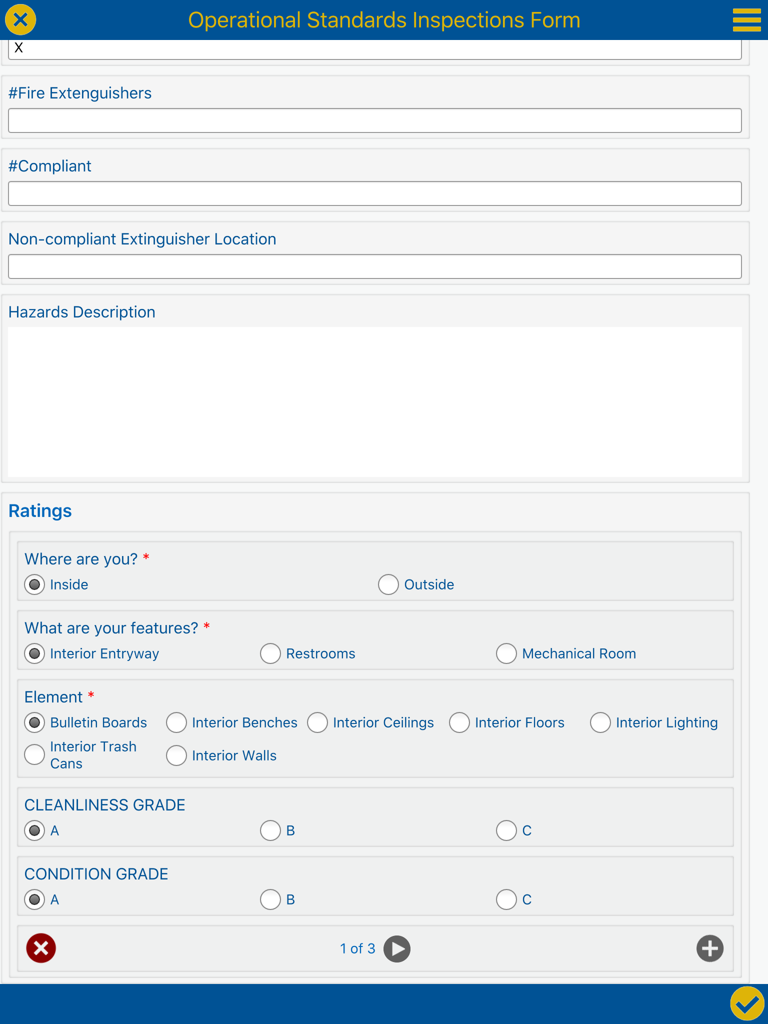

Situation #3- Confirm missing data input from step 1
I have completed  2 pages of the survey and have selected the same radio buttons for the "Area", "Feature" and "Element" fields. However, if I leave the page 3 blank and toggle back to previous pages, selected fields become unselected.
