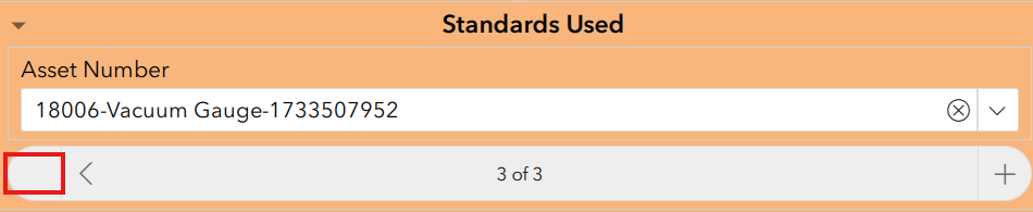

Normally, there is a trashcan symbol in the bottom left of the repeat to remove a record, but it is not appearing once a survey is submitted:
If the reviewer adds another item, it appears again.  But if the reviewer submits that same survey and re-opens it again, it will be locked in:

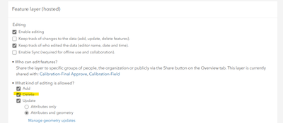

I believe I have the feature layer set correctly:
All users on my end fall into one of the two groups, Final Approve and Field, which are listed as those that can edit.  I'm not sure if there's other settings I need to adjust or not.
