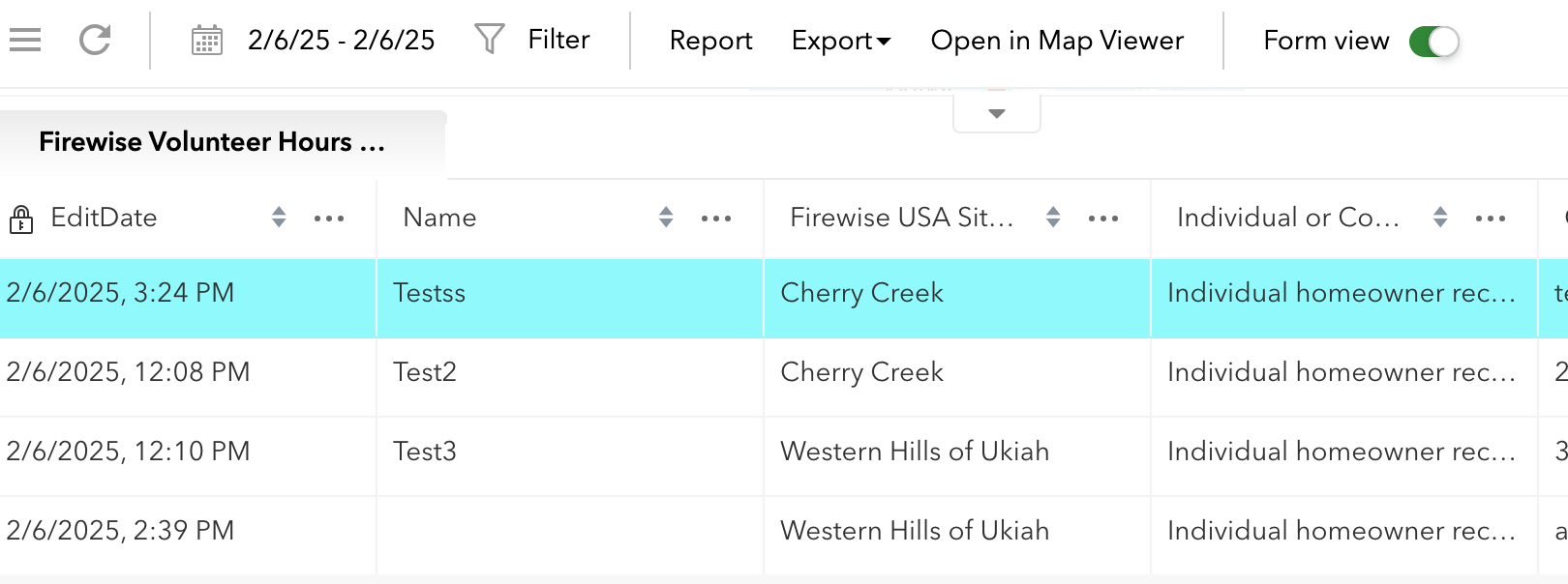

I deleted a question on my survey but it is still showing up on the data tab with the earlier answers. How do I delete the question and the data from the data tab?
I'd like to delete the column "Name" and all the entries. Screenshot 2025-02-06 at 3.46.10 PM.pngScreenshot 2025-02-06 at 3.46.10 PM.png
Second question is: I added a question to my survey after I had published it. On the data tab, I would like that question to come first but since I added it last, it is on the last column. Is there a way to move that question so it appears first on the same data tab pictured above?

You need to go into the AGOL item page for the feature service and delete it there.
As far as order that is always a pain that Esri really needs to fix already.  If its a AGOL webmap then you can change it in the popup and it respects that - well sometimes.

Hi @ScottCratty - "You can delete a field from the Table or Fields view on the Data tab of a hosted feature layer's or table's item page."
and this 3 min video shows how to Delete Survey Records on the ArcGIS Survey123 Website
