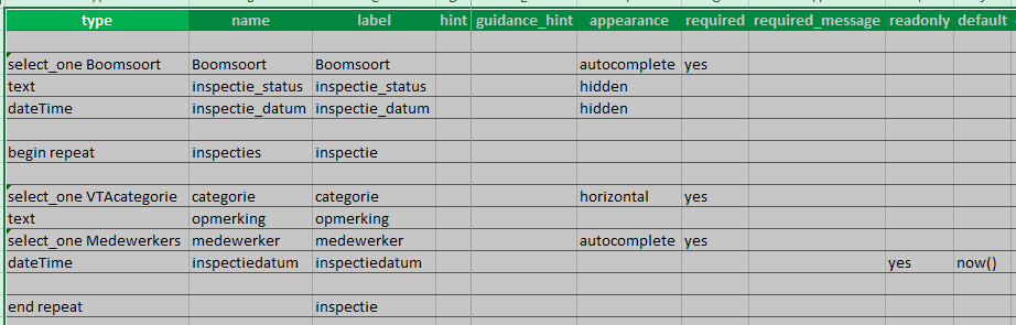

Tapping the link starts survey123 on my iPhone and opens the correct survey but the record/feature does not load, it's just an empty survey (which I can fill in and that will create a new feature but that's not what I'm after) The survey has a repeat section but is otherwise not complex:
What should I do in order to load the feature I tapped on in Field Maps? Is it because I (might) have several related records? is  this BUG-000137679 ?

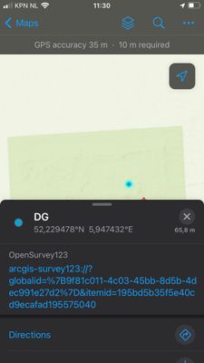

So, if I had an inspection table that is populated via Survey123, what would my URL and/or arcade expression need to be to open a Survey123 form, populated with the information from a specific inspection record, so that I could modify it?
DougBrowning
MVP Esteemed Contributor
JasonCyphers
Thanks.  I've checked them out, with no success.
I'm able to get an existing record to open in the web version of Survey123, but no the mobile app.

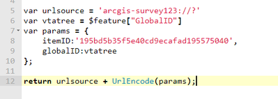

this is my arcade expression to open a survey, create a new related entry and return to the field map afterwards:
var urlSource = 'arcgis-survey123://?'
var vtaTree = $feature.GlobalID
// itemID here means the field maps map to return to
var gotoFM = 'https://fieldmaps.arcgis.app/?referenceContext=open&itemID=1bea04dacb0d4732b367079c039dcbbd'
// itemID here means the survey to open in S123
var params = {
    'field:foreign_key':vtaTree,
    itemID:'15fe03654cb4466fbb760a62dcae8af5',
    'callback':gotoFM
return urlSource + UrlEncode(params);

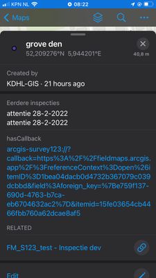

and this is what it looks like on an iphone:
Now, if I only could find that blogpost again where the author showed how to replace the url with a button my happiness would be complete, but I'm quite happy as it is.
I'm sure the expressions can be better but hey, if it works it works...
