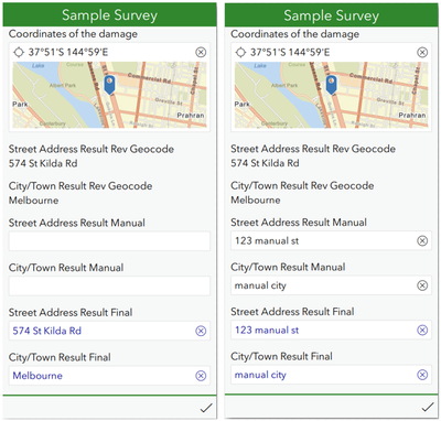

Hi @JaredRyan1,
Here is an example of how you can get it to work with some additional feilds and logic:
XLSForm example attached below. You would want to make different fields hidden or read only to simplify it for the user, but you hopefully this helps.
I tested this both online and offline and works as expected. If there is a manually entered address it will always be used, if there is no manually entered address, the reverse geocode address is used. If you are offline and then go online, and have already entered manual address, the geocoded addresses get updated, but doesn't affect the manually entered addressed stored in the final address fields.

by Anonymous User
Not applicable
Hi @JaredRyan1,
Regards,
Phil.
