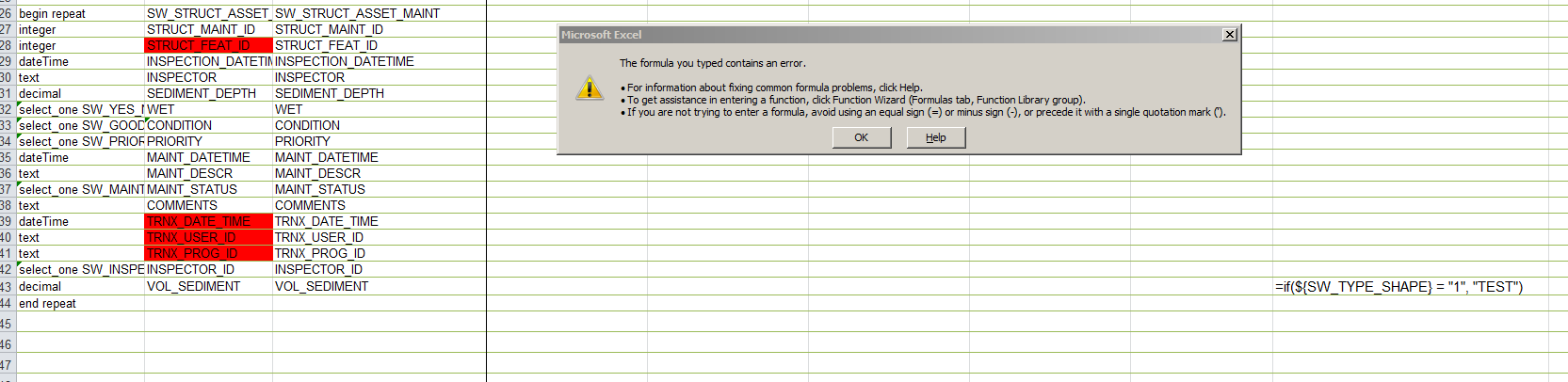

It seems like Excel does not like the $ . What am I doing wrong here?
JamesTedrick
Esri Esteemed Contributor
Don't use an equal sign (=) that is asking Excel to do the calculation, not Survey123.

One last thing. Sorry I am not familiar with this. I get that error
When entering the formula this way: if(${SW_TYPE_SHAPE} = "1", <function1>, if(${SW_TYPE_SHAPE} = "2", <function2>, ...))
It seems like it cannot navigate to the "choices" sheet. I am not too sure how to reference that SW_TYPE_SHAPE.

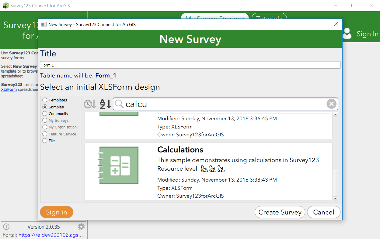

IsmaelChivite
Esri Notable Contributor
The string within the curly brackets references an existing question within your form. Simply put the NAME of the question in your form that holds the values for the shape type and you should be good. The error you are getting indicates that your formula is referencing a question named SW_TYPE_SHAPE, which is not present  in your XLSfile.  Please note that questions are referenced through the value  in the NAME column, not the LABEL.
These links show in more detail how to use formulas in Survey123
https://community.esri.com/groups/survey123/blog/2016/09/06/new-mathematical-functions-make-your-for...
Formulas—Survey123 for ArcGIS | ArcGIS
 The Calculations sample form is also a good reference to get started with expressions in Survey123. You can create a dummy form using this sample and then look at the XLSFile to learn the syntax
JamesTedrick
Hi Alex,
Without seeing your Excel sheet, I can't be certain.  The cropped image provided above does not have a question named SW_TYPE_SHAPE, and the labels don't distinguish which question is which.  What is the name of the question with values you are evaluating (I was simply copying from what you provided as an example)?

James, Thank you for your help. I was not referencing the domain choice name not the actual form question. The issue is solved. I can now enter the formulas in nested IF statements. Great product by the way.
