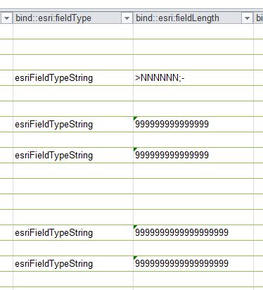

JamesDickens1
James, I am still not seeing this change taking effect. When I update the sheet I should see the limit take effect in the Form Preview correct? Also the line I have marked to make everything caps is not working. I may have to delete each line and then reinsert and code it from scratch?
JamesTedrick
Esri Esteemed Contributor
Hi James,
On relooking at your image, you've placed the input masks in the field length column - move them over to the input mask column.  Field length is used to specify how many characters a text field can hold (as a number).
JamesDickens1
Yep that was it! Thanks for sticking with me on this
