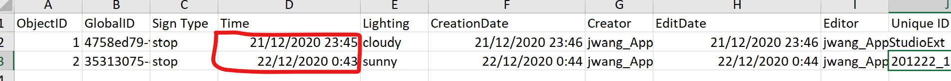

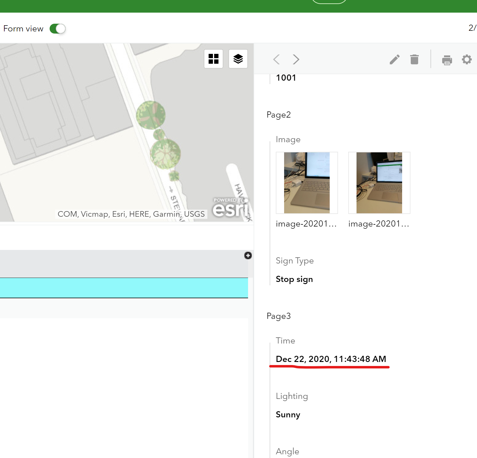

I was trying to build a app using survey123. I tested my app to sent me results and everything looks good. But when I export the data from web (My Surveys -> Data -> Export), I found the time is GMT (UTC +0) rather than the local time I finished my survey. Is this on propose?

Yes, the AGO services will use GMT/UTC.  There are a few ways to adjust either during collection or when downloading.
These links should help with date time fields;
https://community.esri.com/t5/arcgis-survey123-questions/record-time-in-correct-time-zone/td-p/76801...
https://community.esri.com/t5/arcgis-survey123-blog/dates-and-time-in-survey123/ba-p/895528
