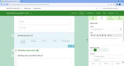

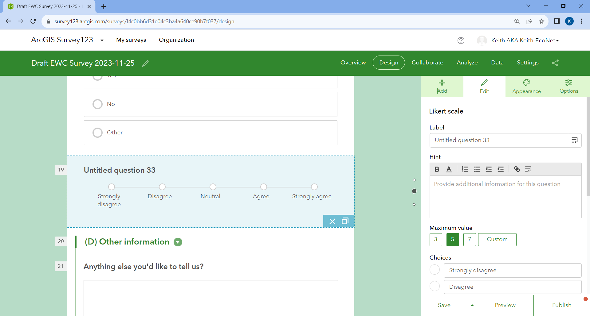

In my Survey123 form,  there is no "Set rule" icon showing when I add a Single Choice, Dropdown, Likert, and Rating question.
Could someone please advise what I can do to make it appear.
I have tried this from both Chrome and Edge.
The screenshot below shows a Likert question in Design mode with only the Delete and Duplicate icons showing.

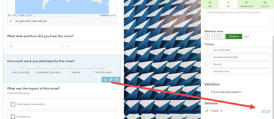

With Survey123 version 3.19 the ability to set rules on all question types has been implemented which changed the location where you configure the rules on the question.
Setting rules is now in the questions settings
Please see this documentation for more information.
