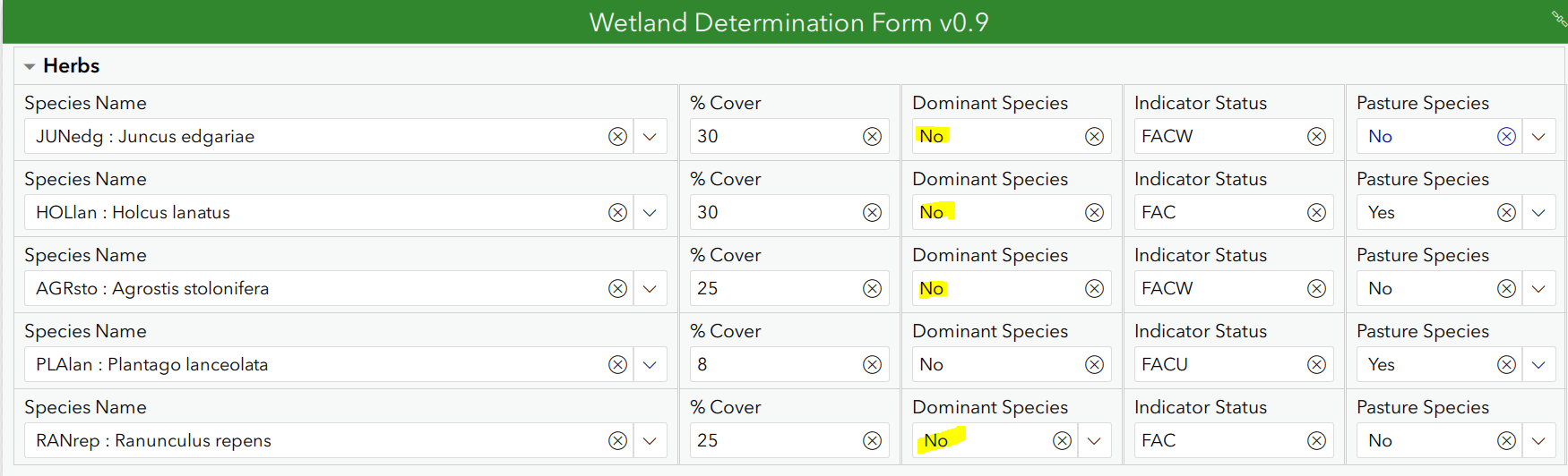

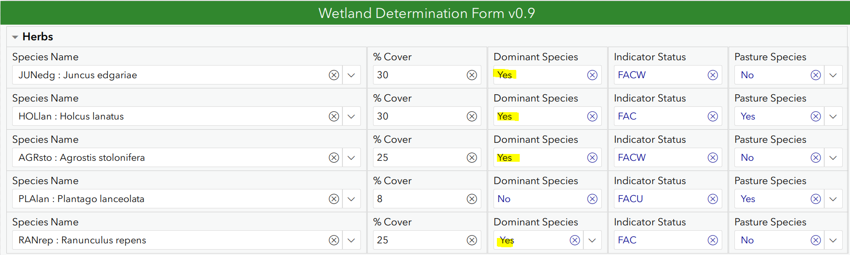

In Connect, when I load up some default data, the calculation works as it should, i.e. flagging that the first 3 and the last species are dominant, however if I remove the default data from the XLSX and reload the survey then complete the survey using "fresh" data, the calculation does not update the field.
This snip shows data that has been entered in the default field, I have not altered anything following the form loading.
If I remove the default values from the XLSX, save it, then load the same values manually, the calculated field  (Dominant Species) does not update.
Deleting the "calculated" value in the Dominant Species field and refreshing does not correct the response.
