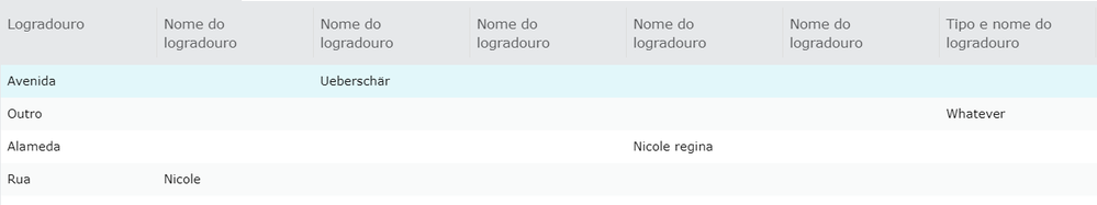

The problem here is that the text field for the name of the street, avenue or  road isn't exported among the other data collected. I've already tried exporting it in FGDB and CSV. Also, on the Survey123 Data tab, the data corresponding to the text field appears normally when I search it on the complete entry, but still doesn't appear on the Survey123 spreadsheed.
I've attached some screenshots of the xlsform, the exported data and the Survey123 spreadsheet (had to blur personal information out of it), as well as the survey xlsform itself, hoping that it can help you understand the context better and maybe help me find a solution for this.

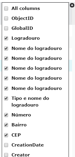

Does the data not show in general for all entries or only for certain filled information? I just tried to reproduce the issue and I am wondering if you maybe just not see the right column? I am having 5 columns with the same label that all show the data correctly.
Sometimes, when you add additional fields after publishing the survey, the new fields are added at the end of the table. So maybe check in the list of attributes if you are seeing all of them (far right of the attribute table in Survey123):

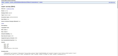

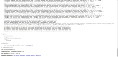

If you go to the REST endpoint of your layer and do a query there, do you see the data there?

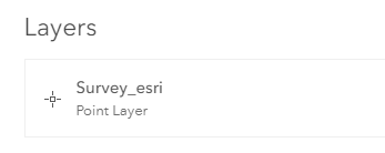

On the Feature Layer page of your survey:
Click on Overview
Click on the Feature Layer of your survey to open it up

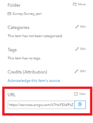

Scroll down till you see URL at the bottom right
Open the URL up
On the REST landing page of your service:
Click on Query
In the where clause, type 1=1
And in the Output fields type a star: *
Then click on Query (Get)

AylaZiger
Thank you, Nicole!! That was exactly what happened.
