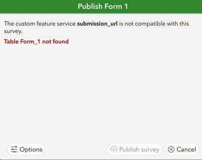

Table not found Survey 123
2752
10-15-2021 06:52 AM
SectoAdmin
Hey,
I am trying to publish a survey and I keep getting this error of Table not found.
this survey has been given to me by a company which we are working with. they say everything is fine and should work ok. I have checked it against the feature service and everything seems fine.
Any help would be much appreciated.
go raibh mile maith agat
DeonLengton
Hi
You should probably have a look at the Settings tab of your survey's Excel design file. The form_id should match the destination table / layer name.

SectoAdmin
thanks for your help Deon
