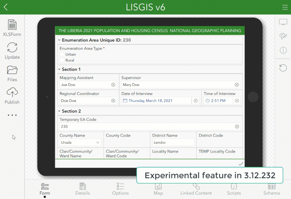

To add to @DougBrowning 's response, we are looking into this and looking for options to accelerate loading times in Connect.  We are happy with the speedy response in the mobile app once the indexes in SQLite are built, but we can also see the inconvenience of these indexes being rebuilt on every refresh operation during design. The slow down varies from computer to computer and we are not 100% if indexes account for all of it. We will soon release a new update to Connect where you will be able to deactivate the systematic refresh of the indexes when you reload the form. We would love to know if deactivating index updates makes a difference for you.
Below is how you can disable the index updates on every refresh. This will be available ONLY for build 3.12.232, which will be released shortly.

Thank you Ismael for your response.  I have since updated to .232 and I've already noticed faster load times for those initial loads.  I'm not sure what was done but it has decreased the initial load time by more than half.
