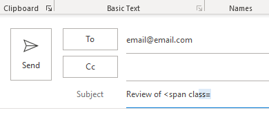

I've added a note to a Survey123 web form that a user can click on to submit an email, with the contents of the survey.
The script in the XLS Form looks like this:
<a href="mailto:[email protected]?subject=Review of ${sp_number}&body=${sp_number} - ${name} has been reviewed, and has a status of ${status}.">Click Here to send status update email</a>
However, when opening the survey in a web browser, the note looks like this:
...and clicking on the link populates a new email in Outlook like this:
How can I modify the code to work correctly?  I've tried various combinations of "?" and "&" before the subject and body, with no luck.

Hi Jason,
Try something like this, using concat to connect HTML code and variables (${}).  I roughly wrote so this may still contain the error, but basically you want to build a code to fit in under a href's url using concat and also the rest of HTML part.
Hope this helps.
concat('<a href="mailto:',${Email},'?subject= Review of', ${sp_number},"&body=",${sp_number}, "- ",${name}," has been revired and has a status of " ,${status},',",>Click Here to send status update email</a>')
Cheers,
Kerry
JasonCyphers
Thanks!  Didn't even think about a concat statement.
