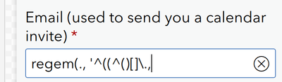

@JamesTedrick
I'm getting this text populating 3.14 Survey123 Connect.
I haven't used the email body::esri:inputMask in a while, what am I doing wrong?
IgorAtamanchuk
Hi,
The regex needs to be inputed into the "constraint" column in your XLSForm. Also, it seems like the preview won't show the validation, but it works well when the form in published. Hope this helps
