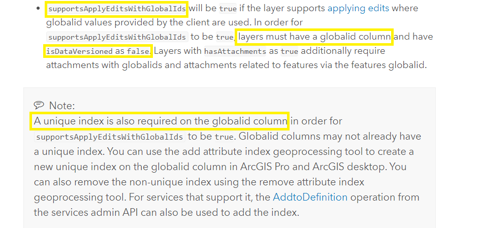

I recognized that [ ApplyeditswithGlobalID ] must be true and to do this data cannot be Versioned.

It is definitely possible to create another feature class to serve as the 'incoming' pool and then copy data to your main database as part of the QA process. As you note, the 'incoming' layer would need to have globalIDs and not be versioned.

Correct,
As you note in the documentation, Survey123 cannot support a versioned feature layer.
